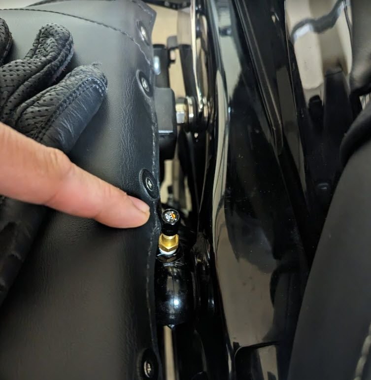

what you did with the air lines?
I routed them under the seat with the fill valve on the left side near the side cover. Easy access with the Harley shock pump, you just have to figure out what works best for you.
Second the Schrader valve. I used the one from Napa NTH 90290. It has a longer stem on it & I can adjust the pressure with the bags on.
