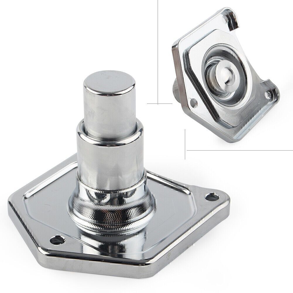

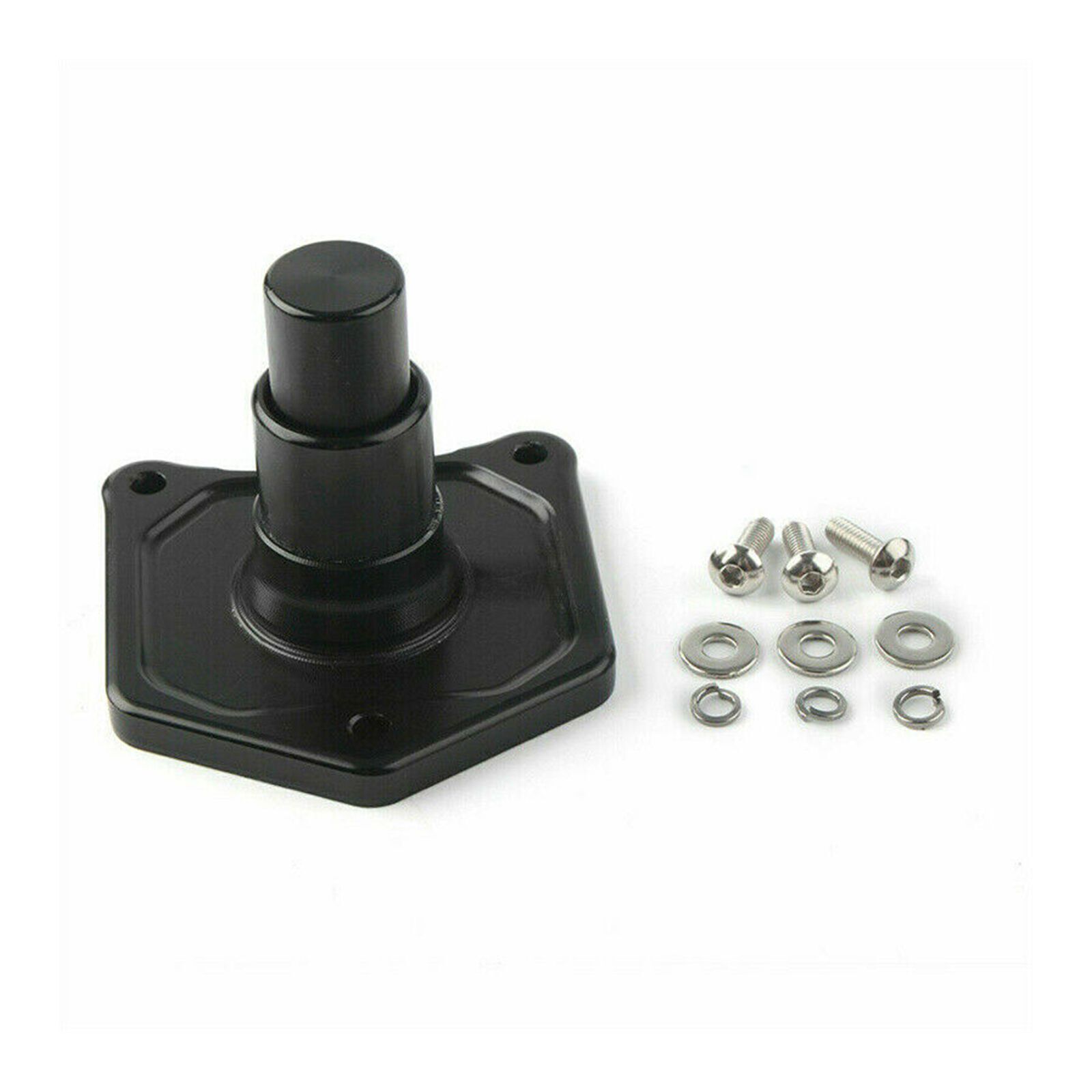

You could install a starter solenoid button, they are available in chrome or black for 1991 to 2022 Sportster models. They are available on Amazon and eBay for around $20.
