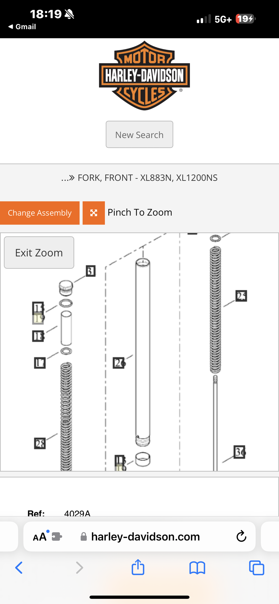

Hello all. I am ordering genuine OEM fork tubes for my 2019 883 after the left side has bent, and I am having some confusion on which part to order. Per the diagrams on Harley’s website, the fork tube is reference number 26. But, when you go to reference number 26, there are 2 parts listed. The first is part number 45500280 “Fork Pipe”, the second is 45500281 “Fork Pipe Comp”. Any ideas as to why they have the same reference number but one is a single number difference in part number? I’m sure they are the same, but just wanted to clarify before purchasing. Thanks in advance

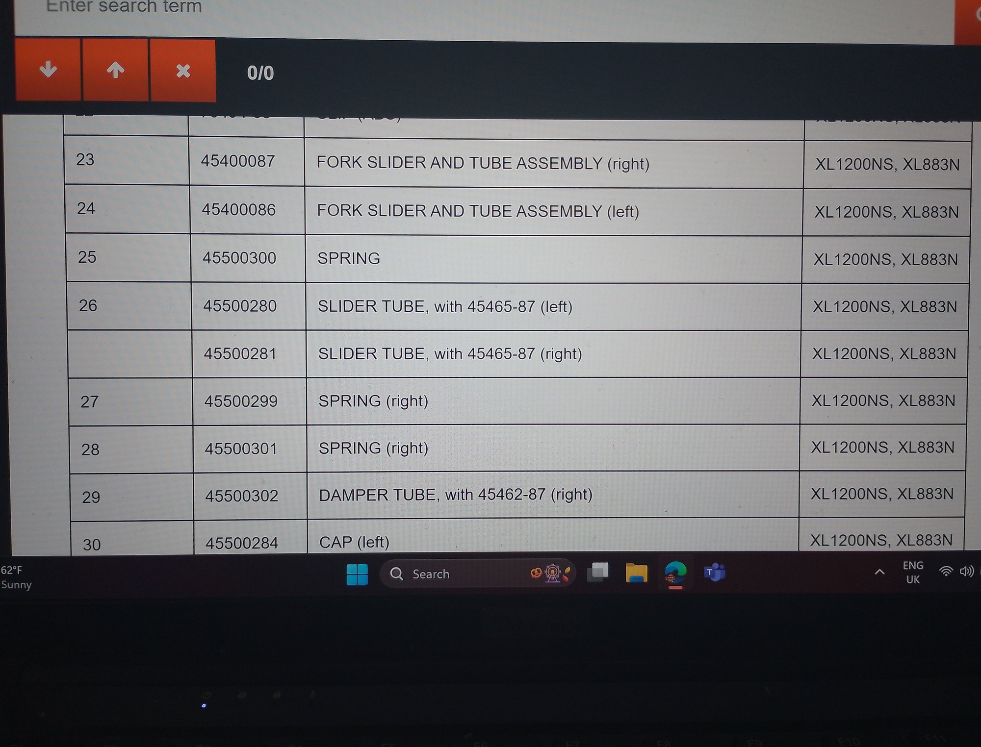

Hello, see below a section from the H-D 2019 Sportster parts catalog concerning the XL883N.
Part # 45500280 is for the left hand side and 45500281 is for the right hand side.
Thank you very much for your help! that narrows down which one I need to order. Just out of curiosity any idea what the COMP stands for on the 281?

Yes, you need 45500280.
Sorry, I don't know what the COMP means as it isn't mentioned in the parts list that I have seen.
