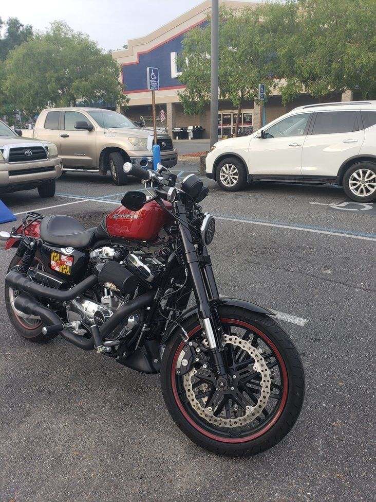

Originally Posted by SumpMagnet
Are there bigger single discs?
On my 2007 XL1200L with the 19" cast front wheel, I have this:
https://www.revzilla.com/motorcycle/...sku_id=1015610
I believe cvaria has the contoured version.
Yes and he also has the HD-Brembo calipers from the Touring models and the newer model Roadster wheels....
