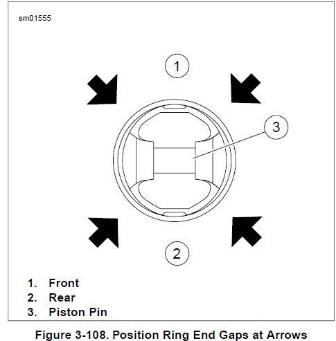

I’m upgrading my 2006 sportster 883 Custom to a 1200 I got my cylinders boared out and got Harley part 22698-01 for the pistons and I can’t find what positions the gaps go on all the rings

All explained in the FSM.
See Figure 3-108. Position rings so end gaps of adjacent
rings are a minimum of 90° apart. Ring gaps are not to be
within 10° of the thrust face centerline.
