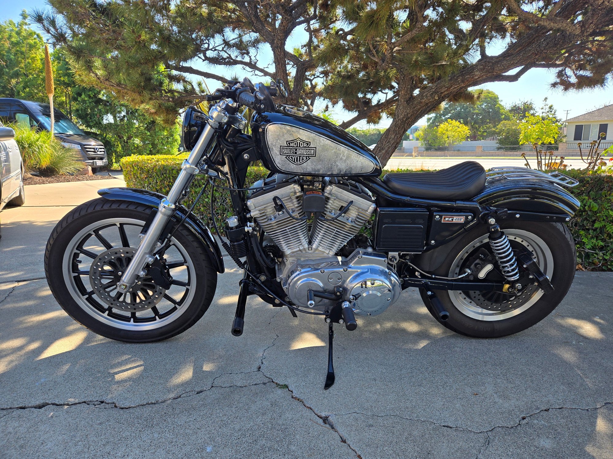

We'll see what plays out with the springer, but there is a high likelyhood I will just keep the showa forks on there for a few reasons. One, I feel like this situation was a bit of a close call. Second, the new setup is a lot quicker than I expected and I feel limited with the springer as to how it handles especially when you really get on the throttle. Third, I don't want to tear everything apart again. Lastly, I really want strong fork stops. You don't realize how important those are until the ones you have are not up to the task. Basically, I think this bike has outgrown the springer. If we can get the springer worked out maybe it will be the start of a new project. Hardtail maybe. I do have an extra motor and a ton of other parts. Or I might sell it. Or maybe just lean it against the wall in my house. It is a beautiful piece.

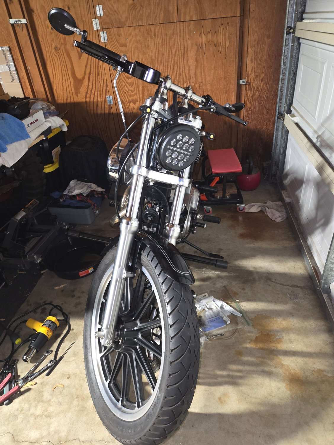

I sure was wrong on this one. Basically nothing swaps over. Turns out the springer setup I have used the Pre-2000 Wilwood brake. Also, I want to ditch the dogbone riders since the standard front end has bushings. Everything is ordered. And now we wait.

Well I finally I got it all together and rewired. Put in some std progressive springs while I was at it. Swapped the risers for some shorter ones and I think I did alright considering I have never actually seen a complete front end for these bikes before a few weeks ago. It's always had a springer since I bought it. That service manual is gold. I'm off to the boat races in San Diego till Sunday so the rest will have to wait. I took monday off to finish it up and go for a ride.

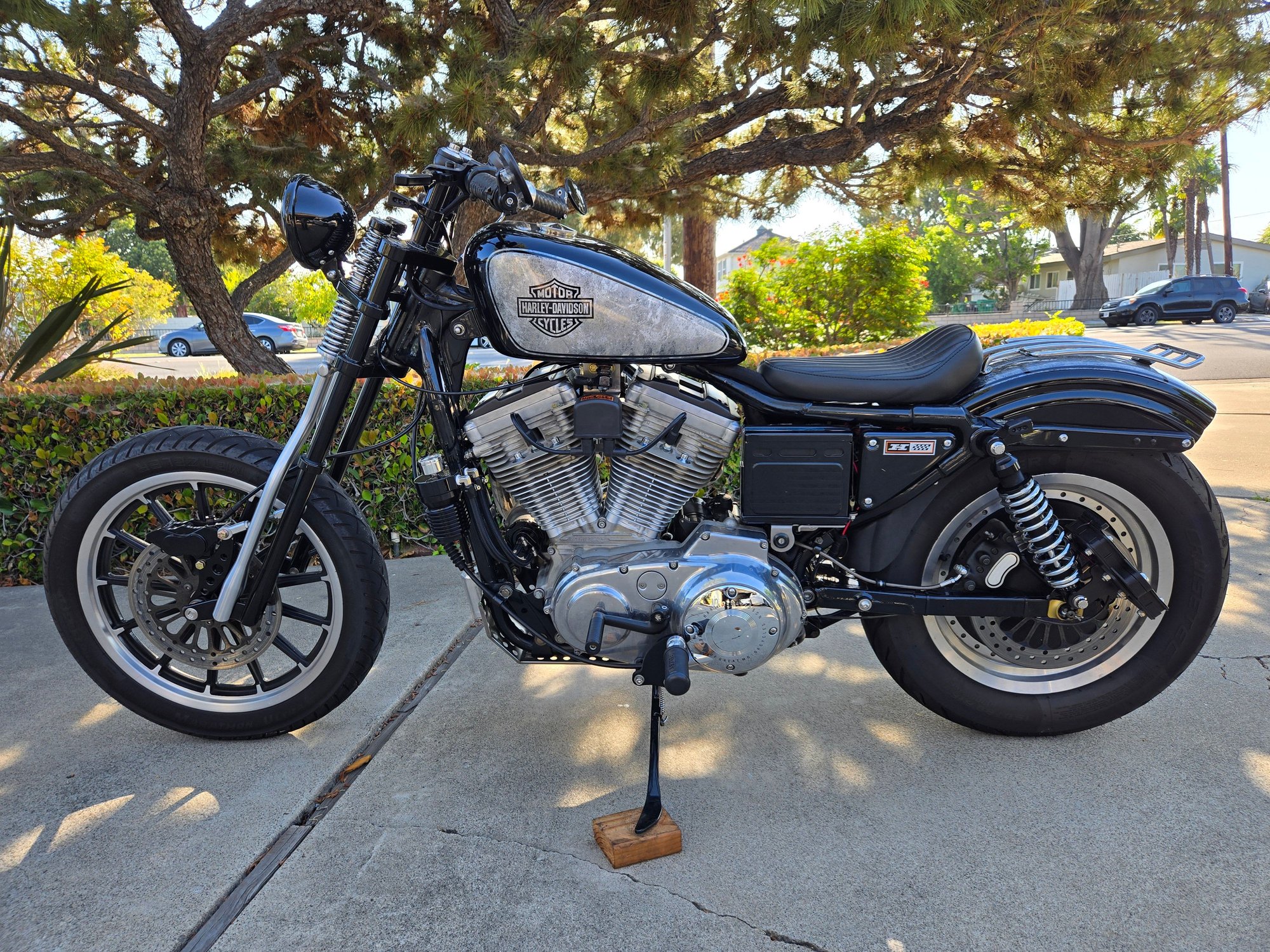

I was comparing pics of the springer/stock front end and I thought it was interesting how much they de-raked the springer to put the wheel in the stock position.
I also have to say that the stock front end (at least with progressive springs) is way smoother and stops WAY better. I had the GP310 on both setups but the GP310 with the stock setup is so much better.
