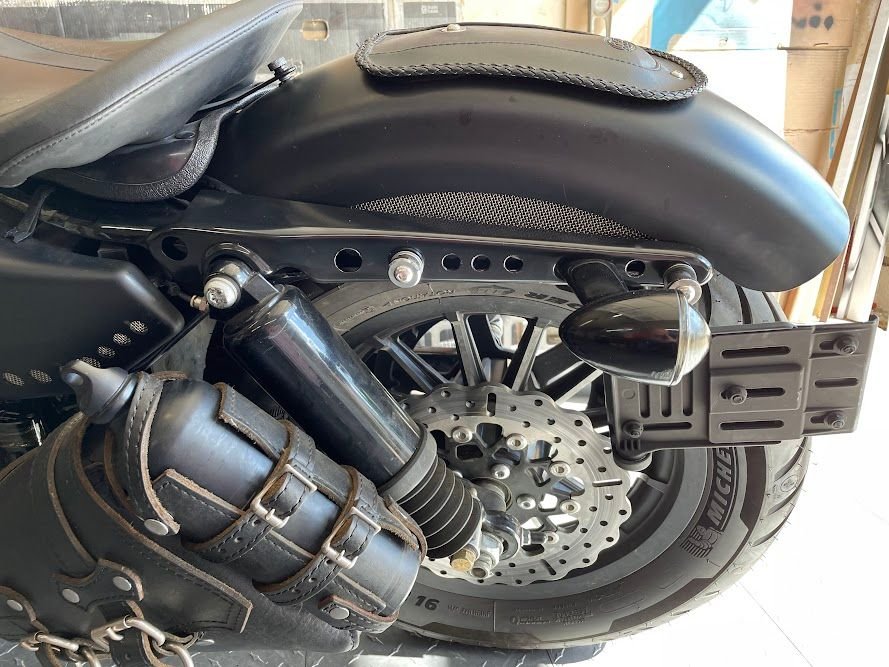

Sportsters are not known for great suspensions to begin with. Lower the shock and it gets worse, so if you're already bottoming out the shocks, you definitely don't want to go any lower.
Generally speaking, the taller the shock, the more travel, and the better the ride.
Have you set the sag on your current shocks? Most people don't bother to set it and wonder why their bike doesn't ride well. If you haven't set the sag, try it and see. It probably won't be Earth shattering but it could be an improvement from how it rides now. And its free and only takes about 10 minutes to do so nothing to lose by doing it.

Yes. I picked up a spanner wrench. It turned out the adjustment was maxed out to the best bump absorbing position.
Looking for rear shocks that afford the best manger ability. I have since learned that a taller shock will do that.

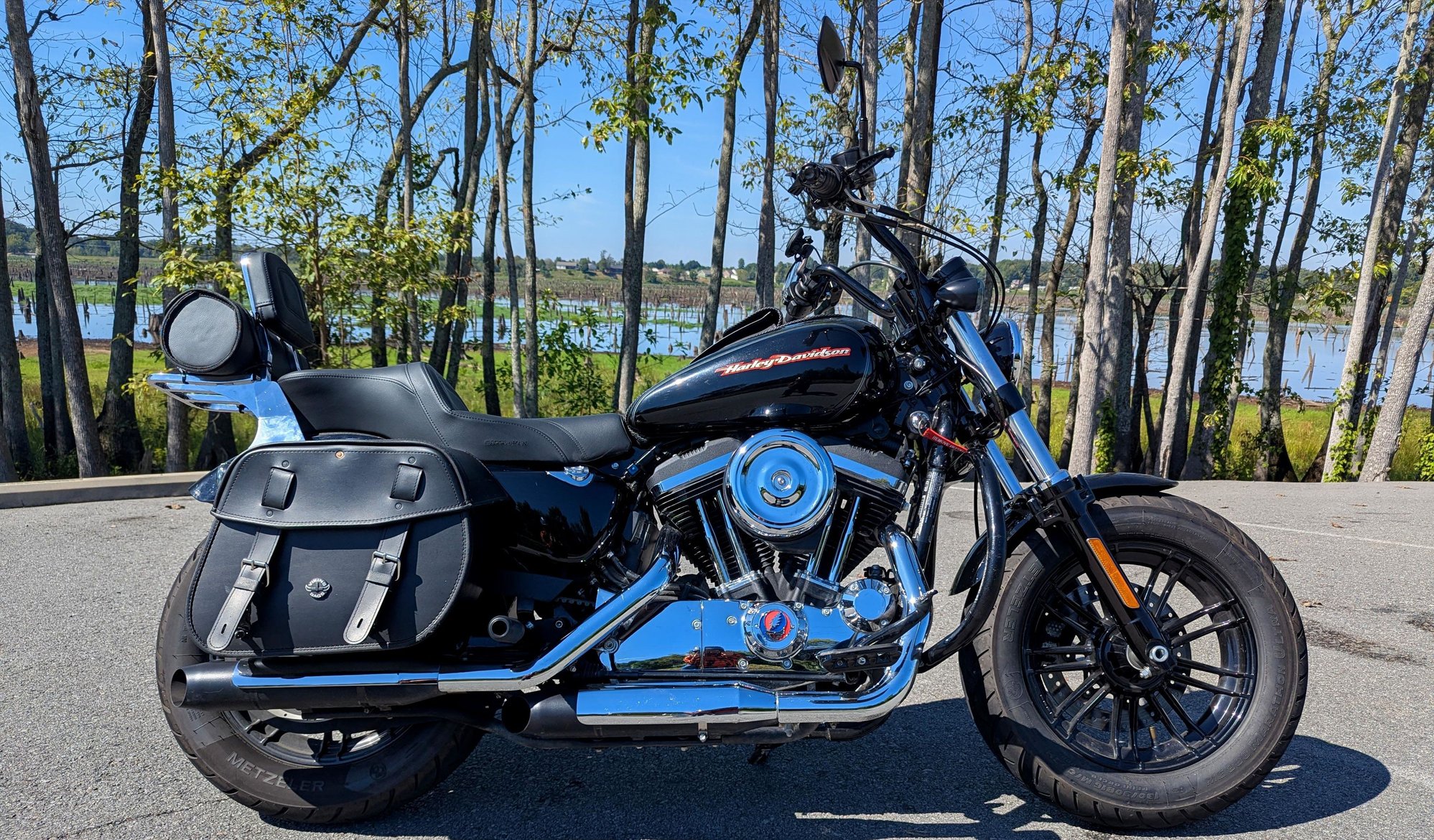

Originally Posted by Fast48
Beautiful bike!!

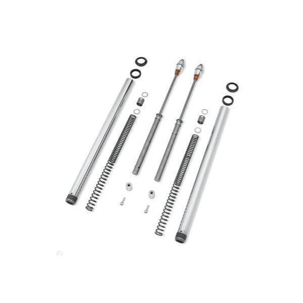

I appreciate your feedback. Would you also say going up on the back provides for a better ride than going lower? Did you leave your forks stock?
This is where my ignorance on these matters gets the best of me. But I'm happy to learn!
I went with a HD fully adjustable fork cartridge kit in front on my '08...but that wouldn't work on your newer bike.
