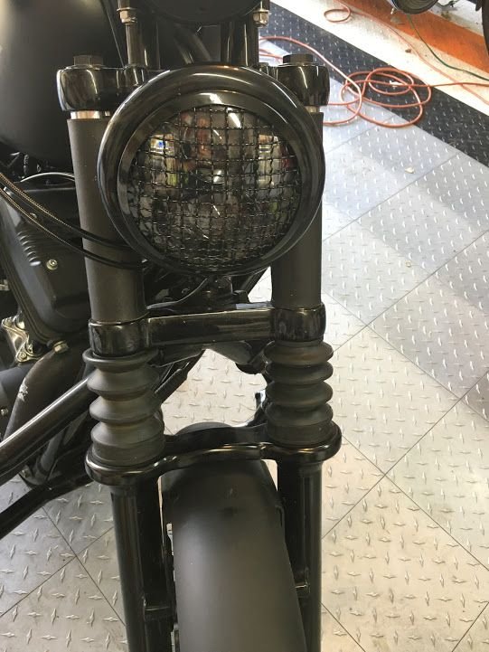

@OCSpringer Just wondering, have you installed
a fork brace?
Just a FWIW, I use a Super Brace, but it seems like
they are about out of business these days...
This is the best picture I have of it....
thanks,
T.
a fork brace?
thanks,
T.
No. Haven't done anything like that. Only change to the front is progressive springs. I've considered it though.
a fork brace?
thanks,
T.
Thanks for the helpful reply. I've looked into this more and given the fact this only happens at high speed a proper brace may do the trick. Too bad SuperBrace is no longer as they seem like the way to go. The HD version seems more cosmetic than functional seeing as it connects to the seal covers. Big Al's seems like the best option for the Sportster now.

I installed a fork brace on my old Iron 883, when a single disc brake is applied, it can cause the forks to twist to the caliper side, a brace prevents that from happening.
