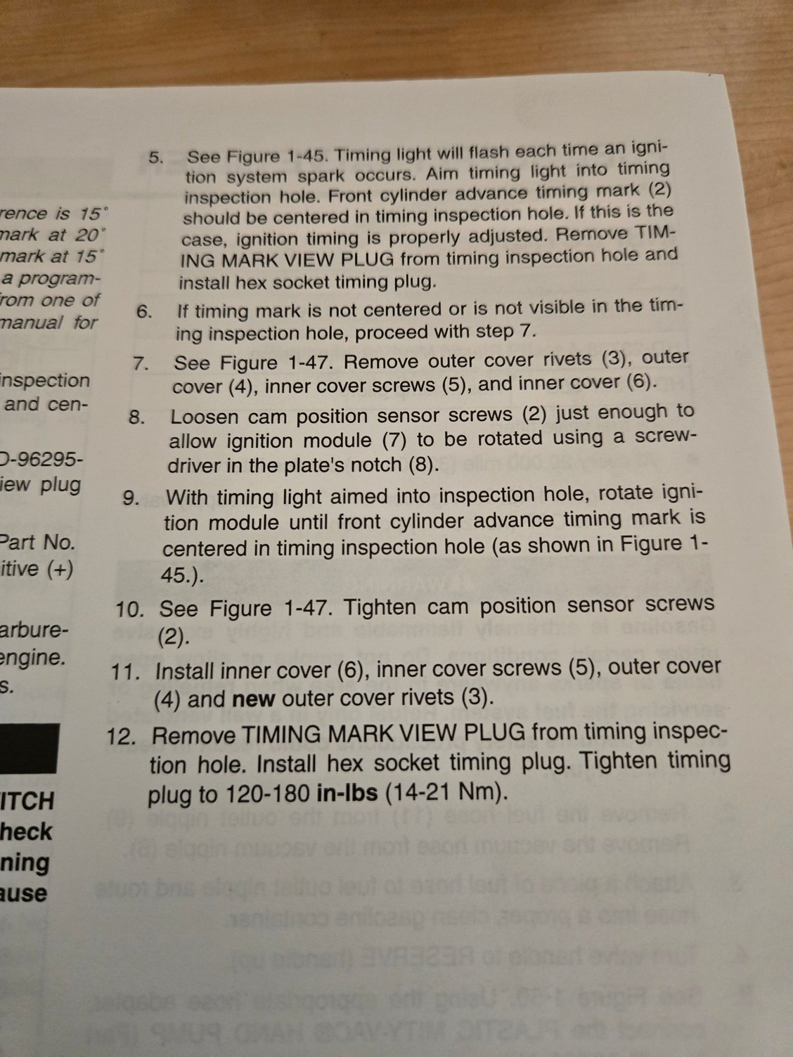

Originally Posted by footclutch
wow old post, im fiddling with the timing on one of my bikes. there was what was left of some old o ring to seal it. i put some teflon tape on it and its been fine.
I just put an oring on my 1998 883, but would like to know what used originally.

Originally Posted by John Harper
There was no O ring on mine when I timed the motor on my 1991 over 5 years ago. I did not even use tape or sealant. No leaks, ever.
John
Ditto. From the factory there did not appear to be any sealant and there is no oring or gasket. The factory manual does not mention the use of anything either.
