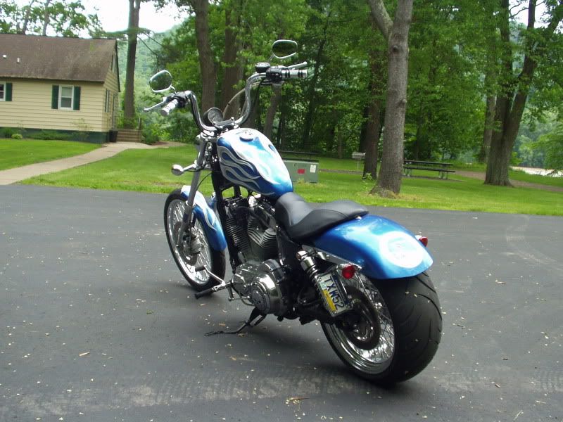

I did a 250 rear tire. I love it and think it looks pretty cool. I am not into slicing through the twisties and canyon carving, I am just into cruising. So this works great for me.
I used a Bros Mfg kit. Their kit was great because it included everything needed to do the job. The only thing I needed to buy myself was the license plate frame and lock-tight! The kit came with decent instructions too, so I was able to do it myself with little trouble.

2004 and up,you can put a 200 on the swingarm.The only thing I had to do was move the fender struts out 2" and get a wider fender.You also have to go to chain drive and maybe get spacers.The weight stabilizes the bike on the highway.especially when 18 wheelrs pass.I learned all I needed on this forum.Anything earlier you need to mod the frame.
