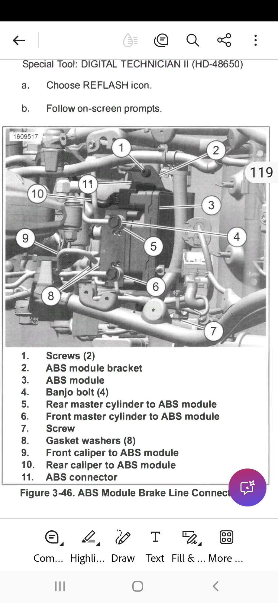

Hi,
Can someone help me where to locate ABS EHCU Unit on 2023 Sportster S. I tried to look under seat and in between handle bar and gas tank. But no luck. Appreciate any help.

I think its all one part- that being the abs module itself- not a separate abs ecu itself. I could not find a separate ecu for the abs listed in the service manual.
Under the seat.
Under the seat.

It's #3 in that image.

Found it. Thank you so much.

Thank you for the details. As you mentioned i found it under the seat. I was little bit tough to reach the harness. But i was able to get it. Once again thank you for the info.
