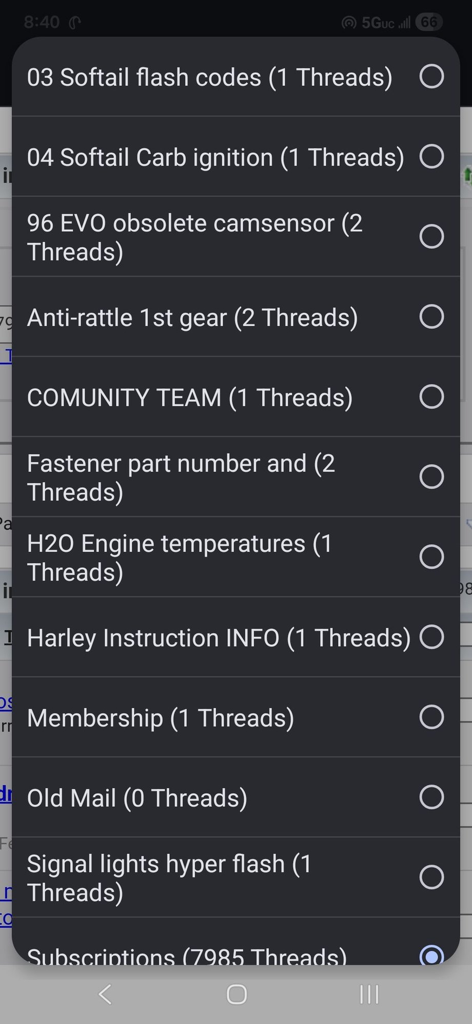

@Exorcist How bought that. Hope you stick around and enjoy the HDFORUM with us.
I added your answer to this thread @RDHIGH to my saved special threads for little known facts on these bikes we call Harley Davidson.
Also told AI the spec. It seems to find related information now on the Sportster S
better.
