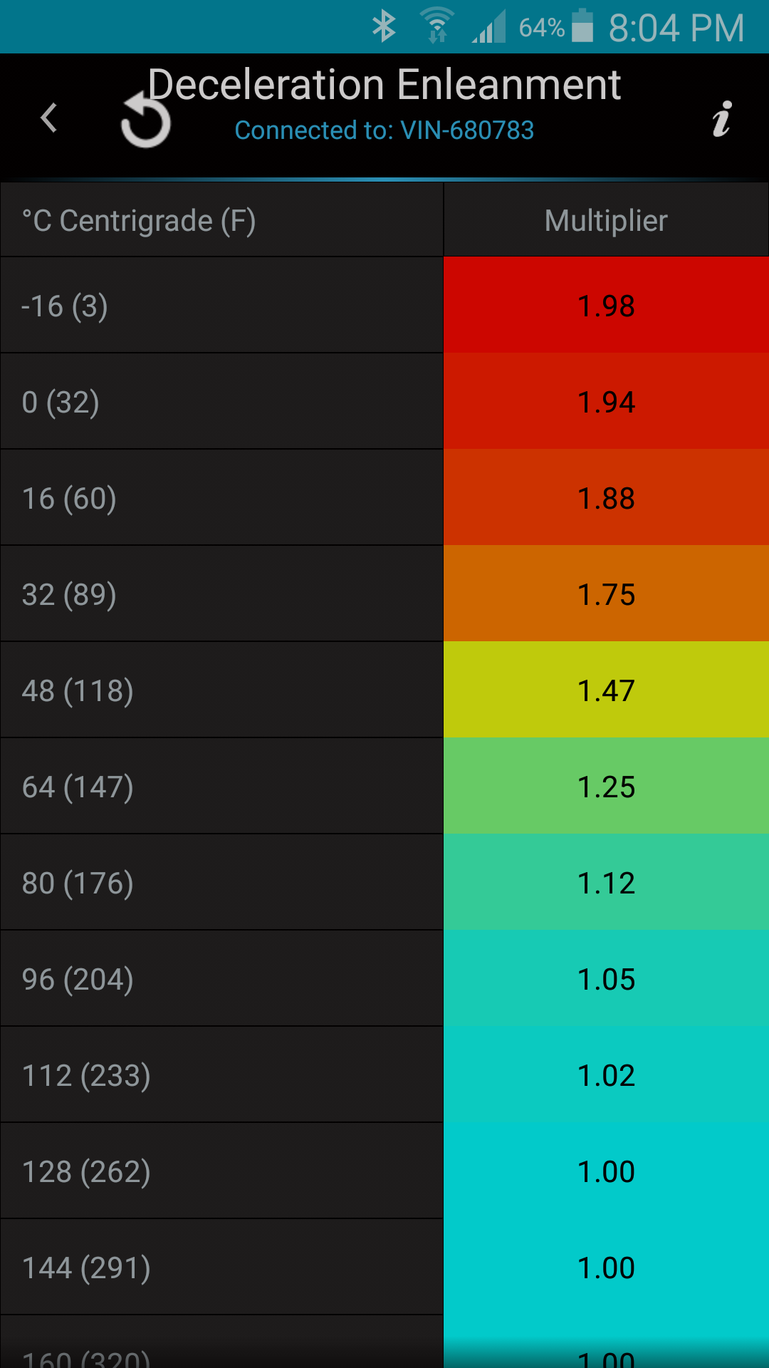

Finally a good stretch of weather to do some trial and error and problem resolved. I started with going to a higher number which leans out the mixture in this transition phase..a bit better but nothing much. I then started decreasing the numbers (couple tenths) as temp rises, richening the mixture. Got slightly worse. So then I started halving the numbers as temp rises and got much better. Did another halving and now gone. Below is my starting table and current table. Thank you to all that responded, I hope it helps someone else with the new fp3 tuning. A users guide with helpful tips would be nice from V & H but other than that its been a good device.
STARTING DEFAULT TABLE
CURRENT TABLE

I know this is an old thread, but I was having the same problem. I changed the deacceleration eleanment settings to what you have. How was your gas mileage after you changed the table. Did notice any ill effects making the change?

Thanks for the reply. Unfortunately, my map isn't available for the TAB Perfornabce 4.5 with Zombie baffles. I'm also running S&S Power Tune Duals which is similiar to V&H Power Duals. Bike is a 2016 RGS 103. I worked with V&H Customer Support and they gave me a new map which works really well, but i do get the occassional upshift pop as you describe.
Last night, I tried using your values in my Decel Enleanment table and it worked out pretty well. I was wondering how long you were running with these new values and if you noticed any issues after making the changes? did you pipes exhibit exessive sut from running richer, did you notice gas mileage going down? etc...

I ran those values in my tune over a year. I noticed no change in mpg before or after the change but that also was not a goal as I was doing well at about 41 on long rides. Around town was low 30s

Thanks for the reply. I will keep these settings as they are about the only thing that has helped with my issue.
