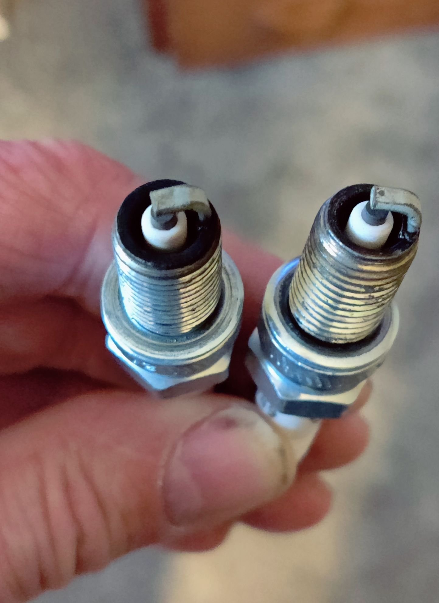

So I'm getting really close to getting my motor tuned in to where I like with my VE tables, timing, air fuel ratios the whole nine yards with my power vision.. Day before yesterday weather was pretty good 43° and overcast.. I put some new plugs in and wanted to try my new Dragy. So I put on about 20 miles before I did a couple of test hits.. Each hit I brought up to 120 mph.. Each hit the bike performed very well, the only issue I had was my satellite connection was in and out so I was able to log any data on the Dragy..
I pulled the plugs today and the front looked real good and the rear probably had a little too much fuel in the idle area.. For My idle circuit I'm running 13.6 on the AFRs but I'm running the rear VE tables a few points higher for the rear cylinder than the front. So instead of knocking down the AFRs, In the area from 1000 to 1500 RPM and 0 to 5% throttle is where I just lowered the VEs for the rear cylinder only to kind of matching the front now..
The timing looks good on the ground strap and could probably even take a little more but it's good enough for me.. I will try to get out next week to see how or if I was successful in decreasing the mixture in the rear cylinder by decreasing the VE tables .

Since you only changed idle mixture taking the bike out prolly won’t tell you much about the change.
Not a good assumption to what is needed in the rear cylinder, at idle, based on theory rather than measurement.
