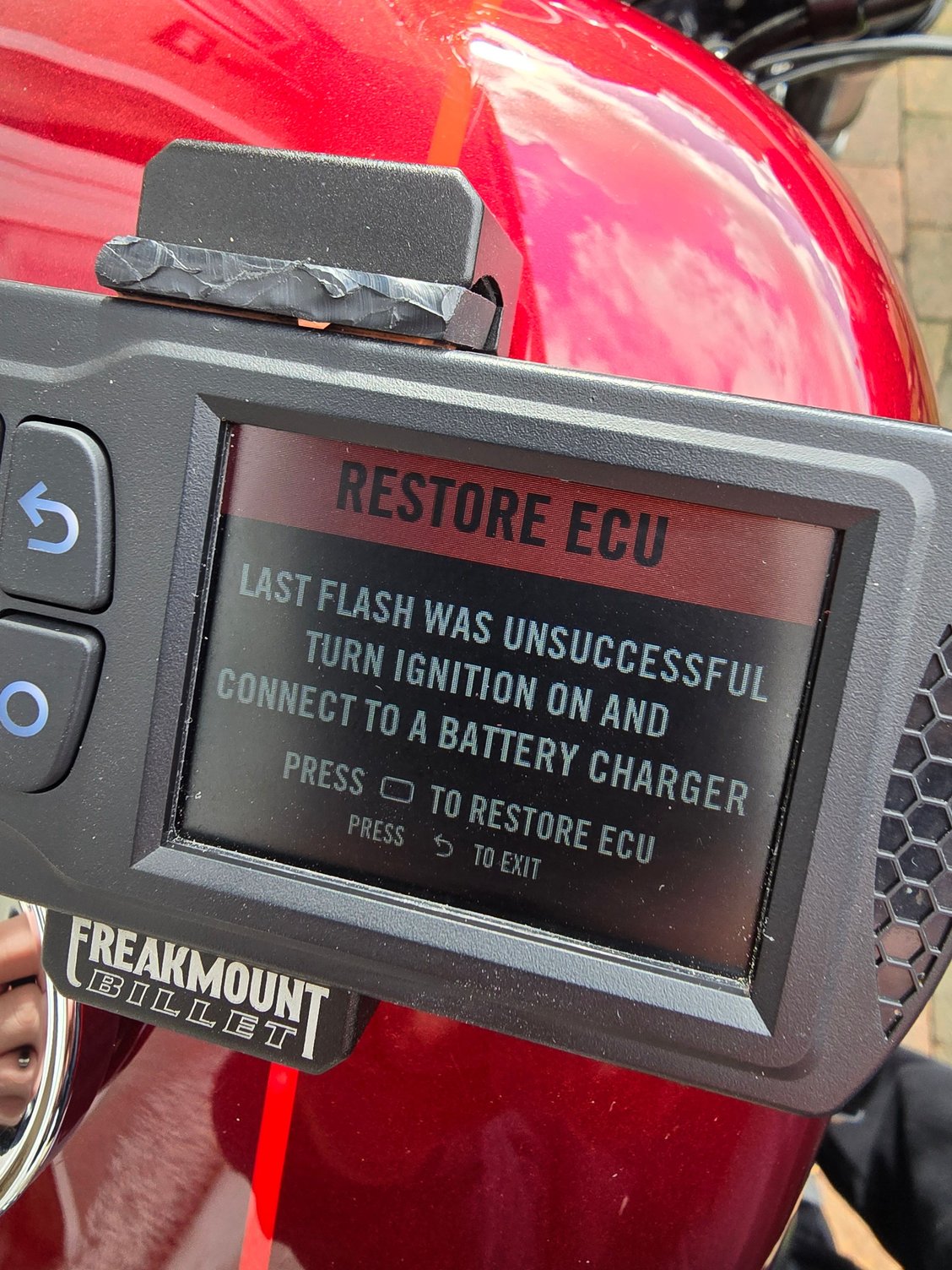

Hi all,

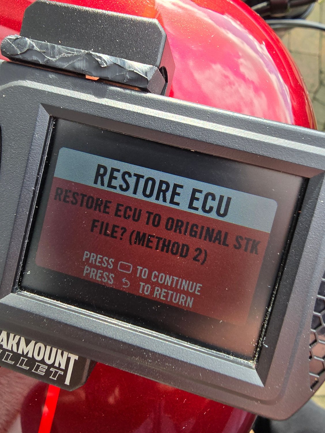

Auto tune basic on PV3 gets me a error 420 after the first run applies fine. Then second run I get a corrupt file.

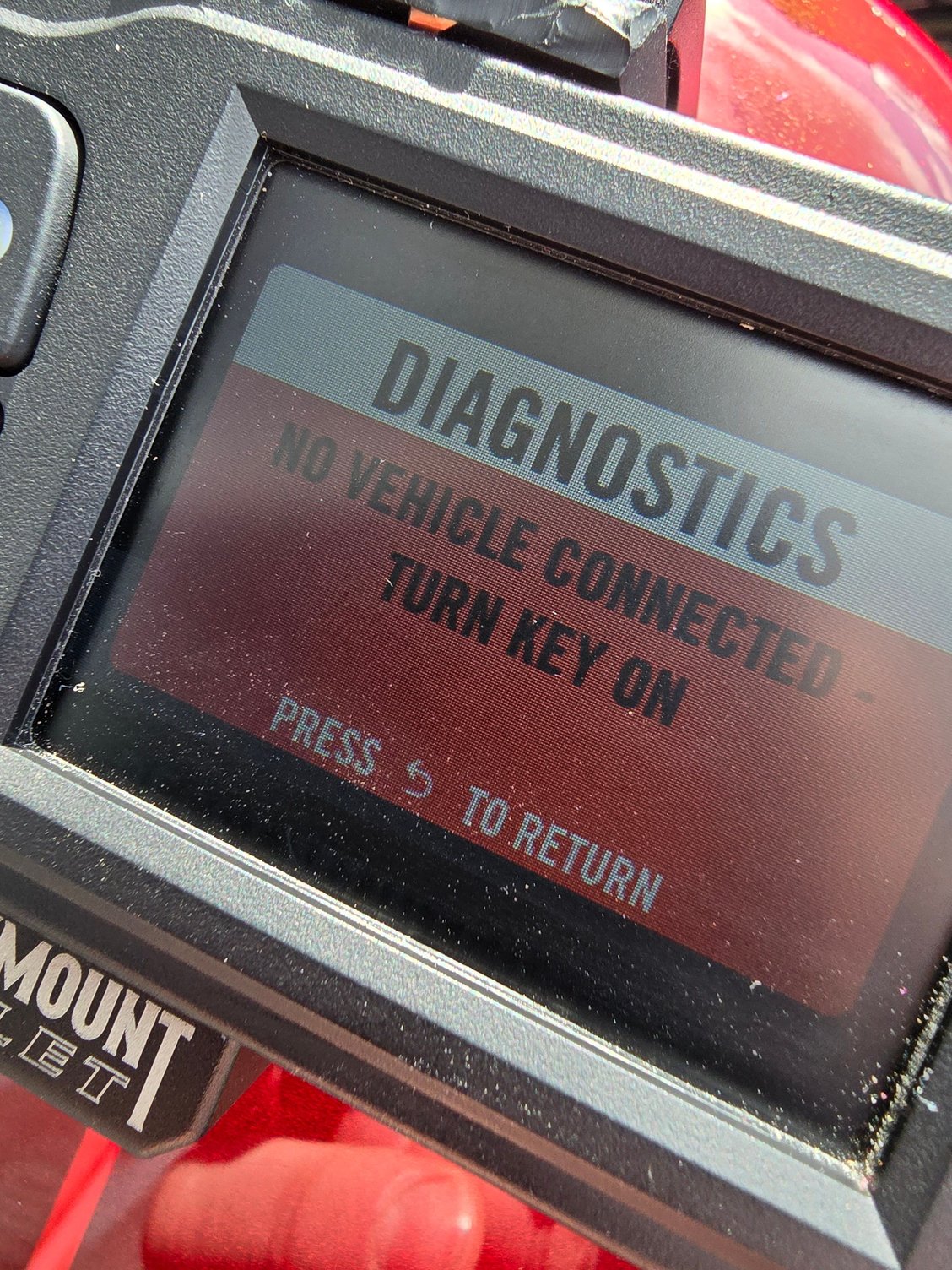

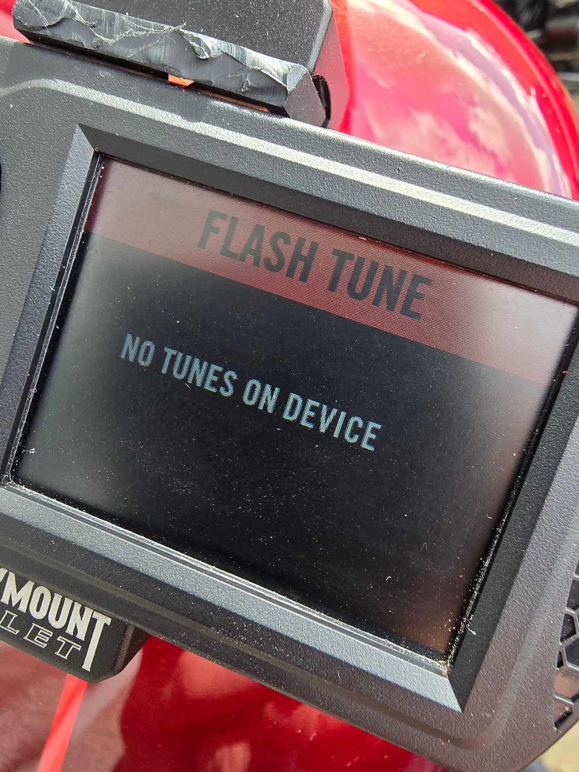

Today I did a format disk, copied my stock stk and fuel moto djt files over and can't flash any? If I go into diagnostics it says no connection.

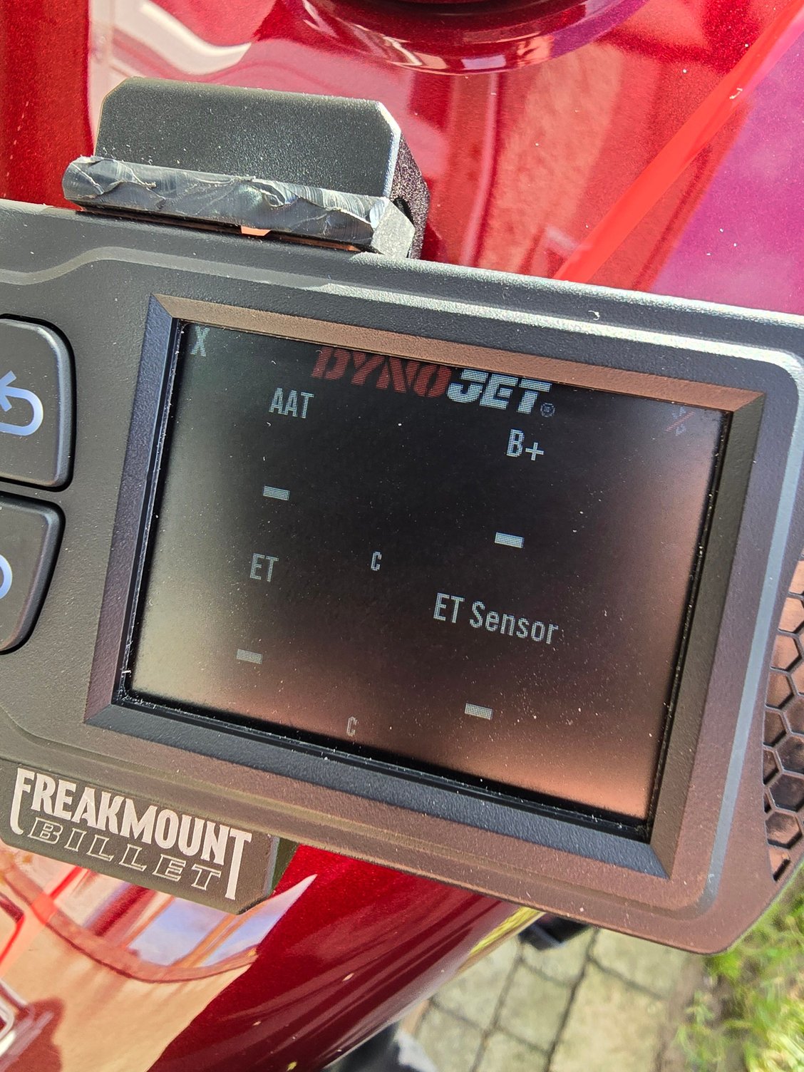

Could I have a faulty cable ? No gauges showing and pv3 says this on start up.
Or could it be I deleted a file I need on the pv3 ?
How do I reset the pv3 also
Thanks

What firmware version are you using?
the latest one.

Battery tender on until it shows full charge, then retry. The system can brick if battery voltage drops beyond a certain level during flashing.
definatly fully charged as it stays on a tender :-) might be the cable still. Waiting for fuelmoto to respond
