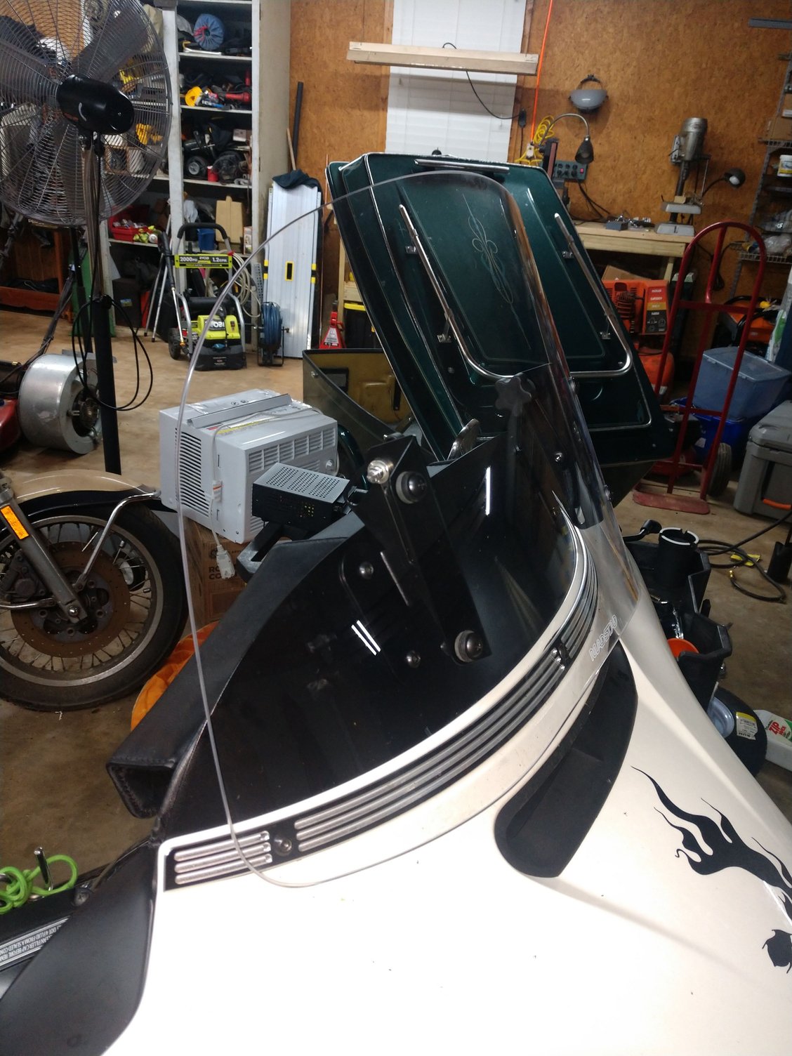

I've been a function over form guy for 40 years, and I know the fangs work, but I also think they remove a little cooling wind from the air cooled engine.
I have the Madstad installed, but it looks like today will be a washout for riding to test the windshield. Tomorrow is looking good!
*Gosh my garage is a mess. 4 projects and I need a dump run!*

I received my Madstad windshield last Thursday, when the rains started. I installed it okay. The directions were not very well written. But it was still assembled and on the bike in 30 minutes.
This is on a 2019 FLHTP. I rode with the stock police windshield for a couple thousand miles. I then purchased a Long Ride Shield 14 inch recurve shield. That was better than the police shield. But at interstate speeds brought up more disturbed air from below the fairing.
I am 6'7", 36 inch inseam, so I sit tall in the saddle. Stock ElectraGlide windshields (with stock seats) are shoulder height for me. Add to that that I am on the stock police pogo seat that raises me up 2+ inches over a standard ElectraGlide seat.
I ordered the 13 inch shield setup from Madstad.
I started with the shield in the lower position, in the full out position so it was upright as much as it can be. I went for a ride in the cold but sunny weather on Sunday. I got up to 80 MPH to see how it worked. I stopped to adjust the shield to tilt back. Each adjustment fine tuned the wind around me.
I ended up with the shield at max height, Second notch from full upright.
The results are good. Reduced buffeting from below the fairing. Reduced, not eliminated. But reduced enough so that riding out a tank of fuel (160-200 miles) is much more pleasant.
I'm not in a pocket of calm air to smoke a cigar. It is not beating me with hard puffs of air like the solid windshields did. This system reduces the buffeting significantly. Now the wind from under the fairing are soft puffs of air instead of a hard push.
The result is I have a much more pleasant ride on the interstate at speeds 65+. I will keep the Madstad shield system. I am considering a 'special order' of a 14 inch shield.
