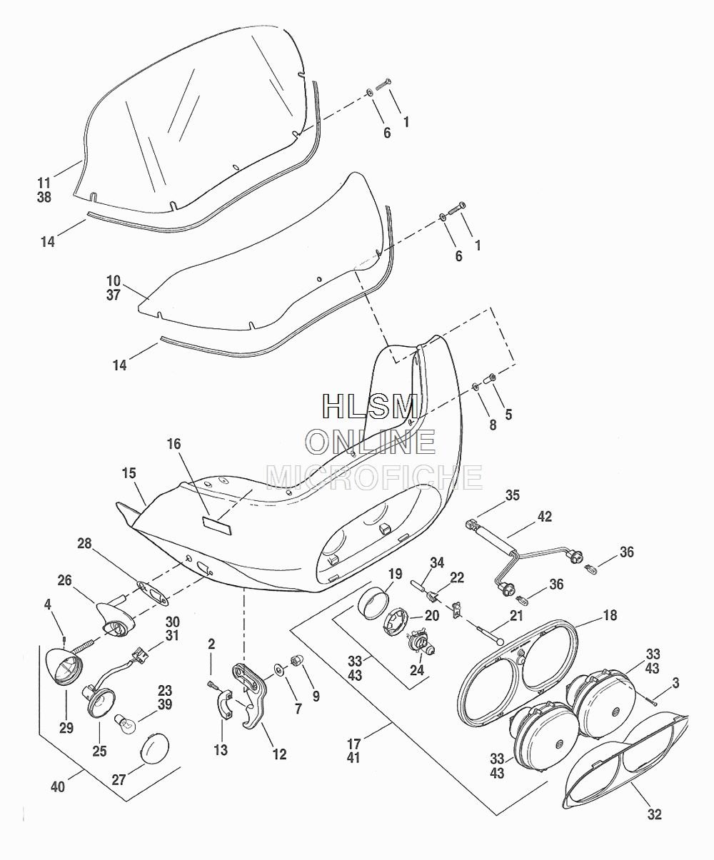

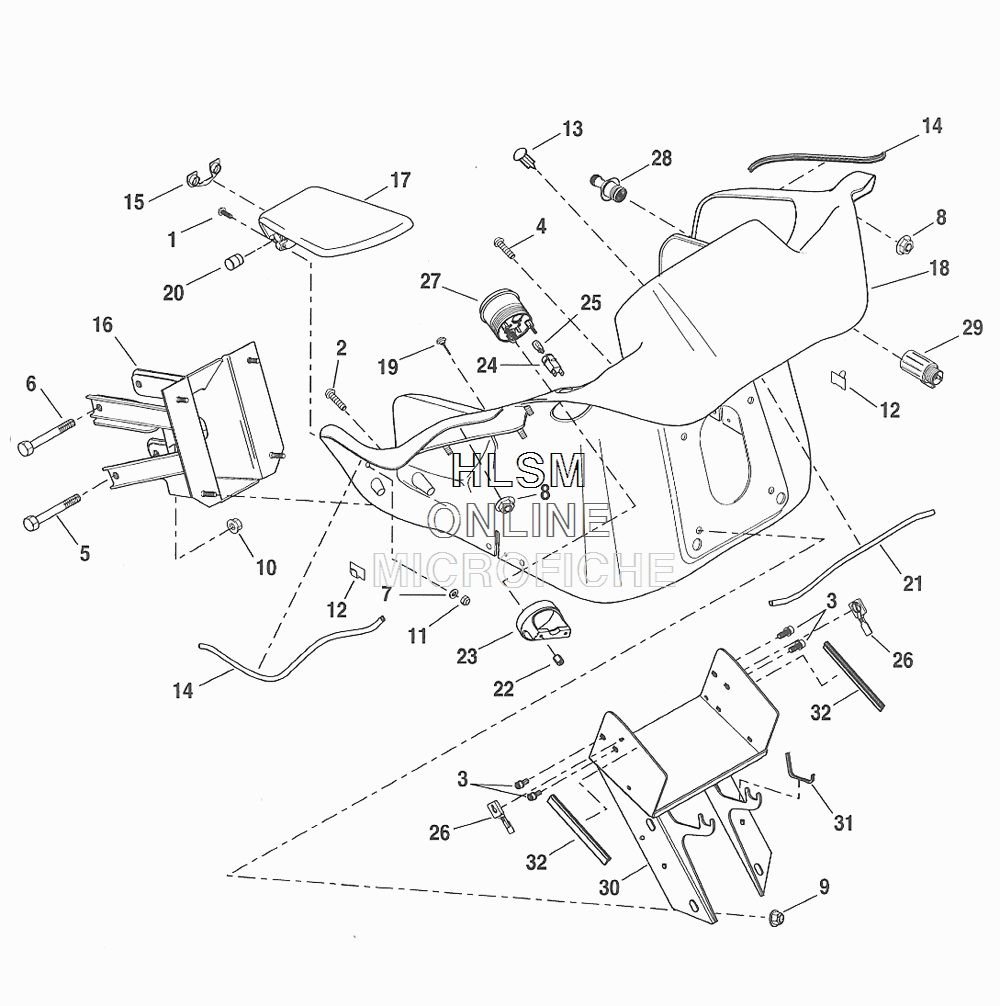

There is an awesome thread right now on and Electra to Road glide.
I'm doing a road glide fairing attachment on my 2008 road king. All the instrumentation will remain as is, just the audio /head lamp will be functional. Does any one have an exploaded view of the parts (brackets) needed to do this. I'll be using a oem outer with a modified oem inner.

Here you go.

Go to http://www.shopronniesharleydavidson...partfinder.htm
You can select the year and bike and get the exploded views and parts lists. I used a 2010 model for the mounting brackets and headlights so I could use my vented lowers. And get away from the bubble cover. You can use everything from a 2010+ on your bike except the interconnect fairing harness! you will need to get one for your year.
Hope this helps.
I posted a link to a excel spread sheet with a complete list of parts needed to convert a batwing bike that I got from Redbeard on my build thread. https://www.hdforums.com/forum/touri...onversion.html
