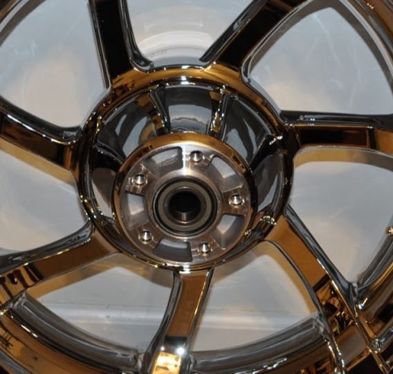

Here is the outside of an installed HD ABS bearing

Make sure your tire rotation arrows are rolling the right way...toward the direction of travel...and that they are mounted/matched to the rotational orientation of the wheel. The front ABS bearing is on the left side, the rear abs bearing is on the right side.
ORANGE SIDE GOES INWARD.
Pic of left side of front wheel. ABS bearing with gray/olive side out:
Proper install sequence is to seat the abs bearing first in the wheel hub without over pressing the bearing (ie, use plenty of assembly lube or some kind of lube). Then turn the wheel over, insert the inner spacer, and install the non-abs bearing until it BARELY touches the inner spacer. Use some silver antiseize on the axle when re-installing.
If wheels, tires, and bearings are installed correctly, then check the abs data line. There is a connector under the left front faring that can come loose and lose signal from the front encoder. So check that connector to be sure it's tight. Also check to ensure the rear data like is tight.
