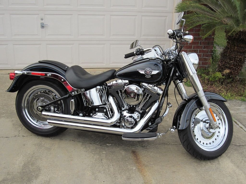

Only thing I didn't like about this bike was the pinstriping.
