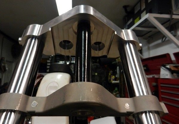

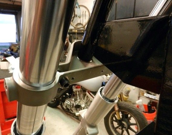

The new 49mm fork fit in the new 49mm triple trees. They all (FLT) look the same & have the same part #.
If you look closely you will new see that the bottom triple tree sits flush with the bottom of the steering head. The 1986~2013 FLT are different and the steering head sits "inside" of the bottom triple tree.
(picture of my 49mm bottom triple tree) Above
Why would this matter? Because the fender stops/hits the bottom of the bottom triple tree limiting the stroke (your friend).
In order to clamp triple trees together onto forks (different angles) only intersecting at the exact point where the two trees hit the neck bearing seals (top & bottom), a two piece steering stem must be utilized. Since Harley wanted inexpensive, they forge the two steering stems and thread one into the other. In order to do this, a 1" steering stem (the size of your older ones) is unacceptable so a larger OD must be made. You have neck bearings s the ID of those must be fitted into the new neck. Your 1986~2013 FLT does not have a large enough neck bearings to let the steering stem pass through.
The second reason for getting rid of the old fork tube non clamp system is for stability. I have been pointing out these inadequacies for many years now on this forum.
V/S
The next thing HD did was get rid of that domed steering stem neck bearing pre-load nut that wobbled so once the slip fit fork bolts threaded in, the top tree could be tightened down onto the domed nut and onto the fork tubes. A very wobbly and loose fit on a major component.
Not that anyone asked, the old 41mm fork tubes have a 0.165" wall and the 49mm have somewhere around 0.110" (I just measured them now). The 49mm are noticeably lighter (holding each in my hand) and by far much more rigid due to a thing called cross section.
There you have it.
PS: I make my bottom triple tree out of 17-4 PH STAINLESS and make my bottom steering stem out of the same. I believe that drilling a hole and cutting it down where the threads are create a week spot and pressing it into the sand cast mild steel is not something I want to do. I make my top bolt out of the same material also. It threads together with a specialize nut where there is no week spots. The top bolt/steering stem is clamped by the top tree with 2X 5/16"X18 Alan bolts. The bottom steering stem is cooled, pressed into than welded into the bottom triple tree.
