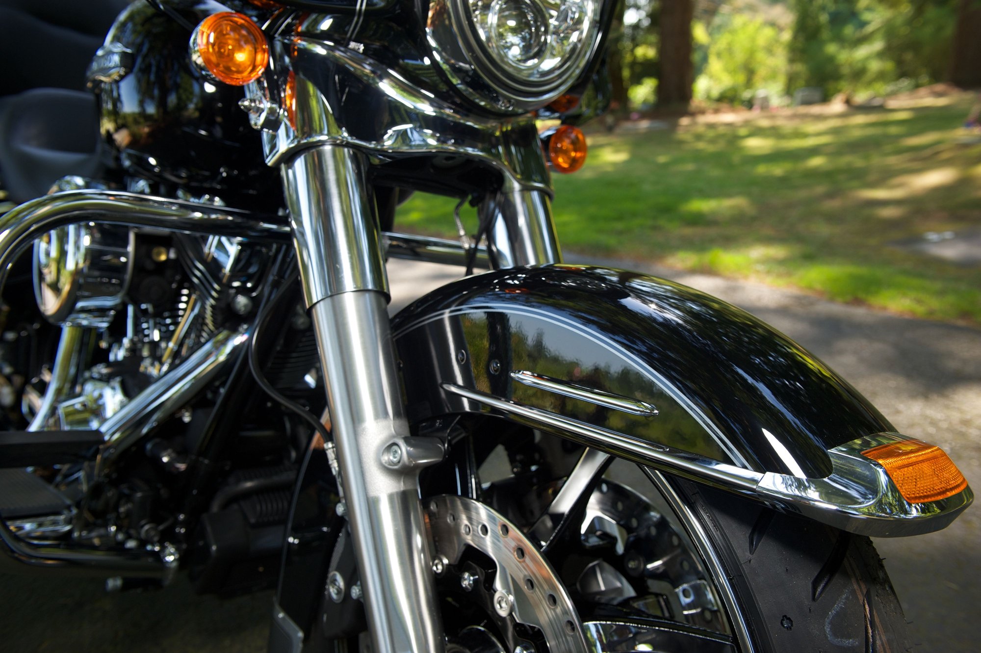

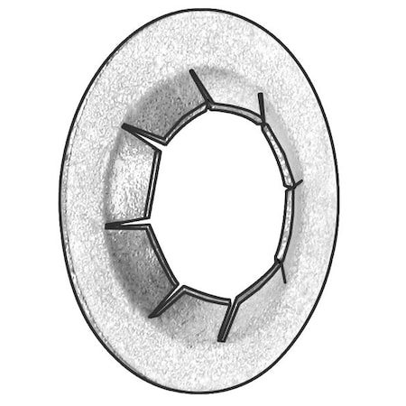

Pretty easy, they are held on with two (each) push nuts like this:
You can order them from the dealer but they are common hardware store items. It's best the remove the outer fairing and unplug the fender tip light which is near the left lower triple clamp. Then you can remove then fender and pry off the push nuts holding the badge on and replace them with these simple (and heavy) bars that are on police models and HDI CVO Limited models. The bar is about $20 each from the dealer.

Thank you. Very helpful. I appreciate U detailing out the process & adding the pix. Ernie

...... i gotta say, that i prefer the bar to the '14+ script badge

I've hated that Limited logo since the day I saw it! The Bar is understated and complements the finder light design.

The '14 and newer Limited badges are NOT just stuck on with push nuts. They are on with sticky tape as well. I know, I took the ones off mine when I swapped the stock fender for a FatBoy style. It was PITA to get that stuff off even with goof off. As for an item to cover the holes, the '13 and earlier models have a different front fender, the holes on the bottom piece are NOT the same, I'm not sure the holes for the badge would be the same as well.

Well, I checked and sure enough - the Ultra parts fiche shows push nuts and the LTD does NOT........taping them on must be one of those "premium upgrades. But the base part number is the same so the holes are still there and a bar with push nuts can still replace the badge.
