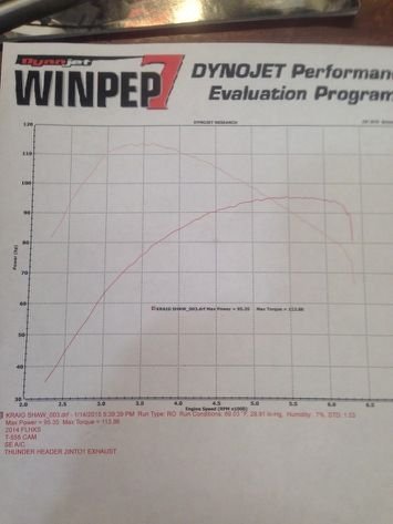

I wanted to share that this since I couldnt find this build to compare dyno numbers before I did my build. T-man 555 cams and Thunderheader 2into1. I got 113tq and 95hp. All the other builds I could find with this set up had heads too and I wanted to give people something to compare to without heads.
2014 Street Glide Special
103 T-Man 555 cams
Thunderheader
SE lifters
SE a/c

Nice!

new to the sight so not sure my dyno sheet is posting.

Very respectable! Great return on the dollar on that build!
