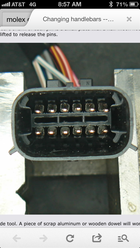

Is this where your having trouble trying to get them out of this connector?

Yes!! They werent budging yeaterday.

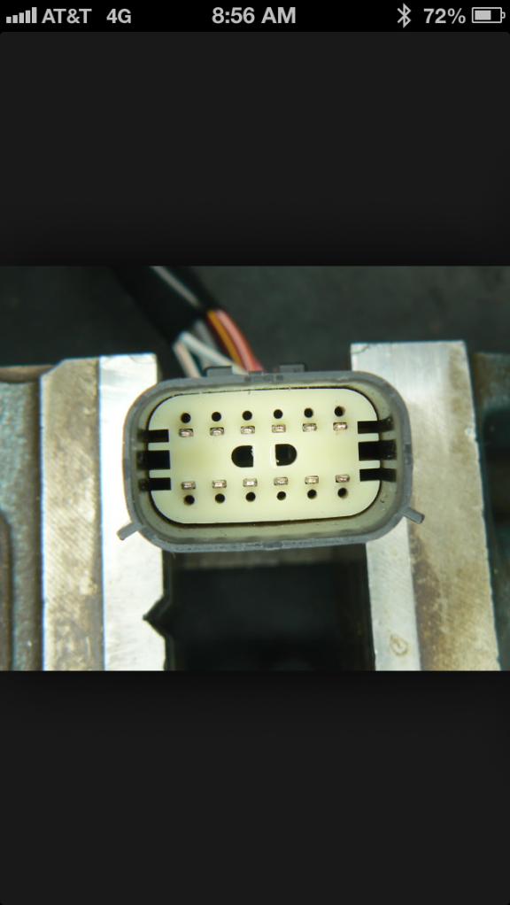

Ok you need to pull up on the white insert till it clicks, using a pair of needle nose pliers, then use a paper clip or small screwdriver to unlock the pins. This pic with the insert removed shows the locking tab above each pin. There's a small half moon shape in the locking tab. That's where you slide the paper clip in and pull on the wire.
