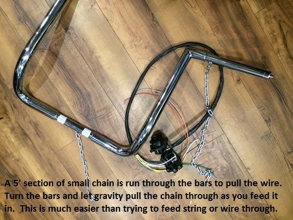

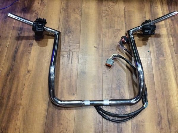

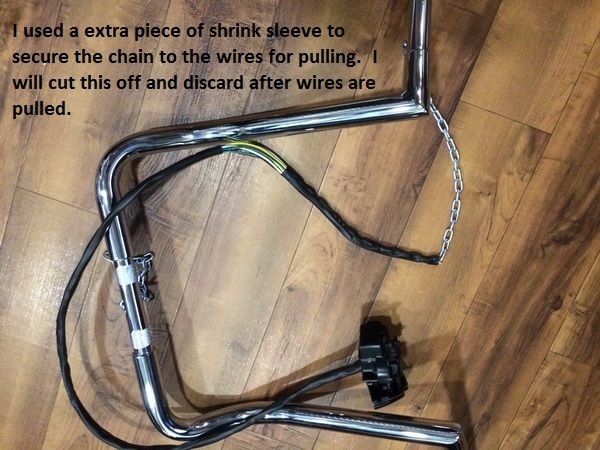

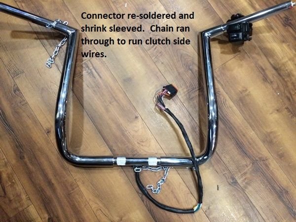

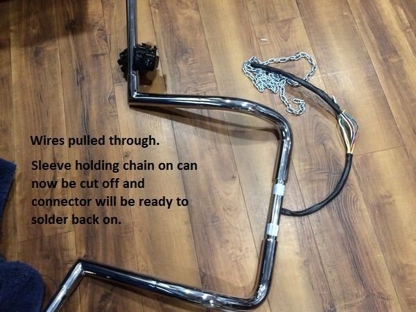

I am putting a 16" set of LA Choppers Twin Peaks on my 2001 Electra Glide this week. Following advice I found on here, I finished the wiring tonight. Instead of a kit, I used 24" lengths of different colored 18 guage wire. I staggered the cuts, and soldered and shrink sleeved each one. I used a 5' long small chain to pull the wires. I ran the chain through a few times to knock down any sharp edges inside.

I used a different chain, but same concept....gotta love these visuals - thks!

This was the first time that I tried the chain, one of Iceman's previous posts gave me the idea. The first side that I did took maybe 2 minutes to figure it out. The second side took about 30 seconds to feed it through. Just shake the bars a bit as you feed it through and let gravity do the work.

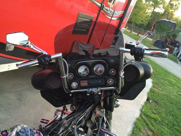

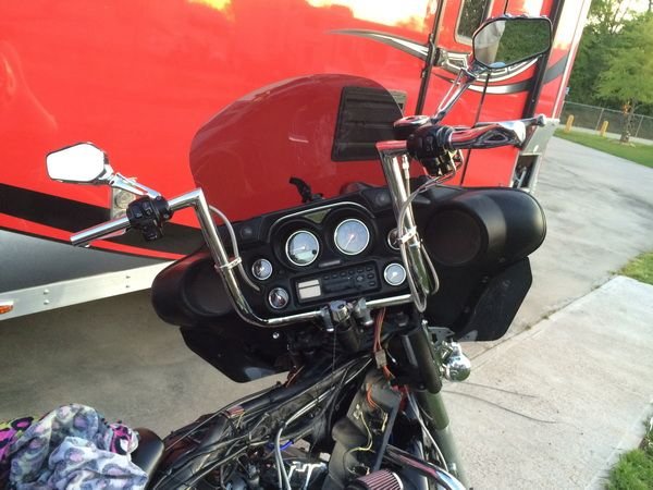

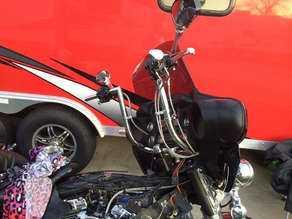

Here are some early pics. I still have to get the left grip on, the camshaft and crankshaft sensors replaced, exhaust put back on, in tank fuel lines and filter replaced, tank put back on, battery replaced, front and rear brakes bled, and clutch adjusted before I can take it for a test ride. Sometimes my small projects get out of hand, this started out as a swingarm upgrade...
Old Mar 28, 2015 | 06:38 AM
Buffalolake's Avatar
Buffalolake
Joined: Mar 2013
Posts: 208
Likes: 8
From: Terlton, Ok
I'm going to ditch those mirrors. They looked good when they barely came above the fairing on the old bars, but they look ridiculous now.
