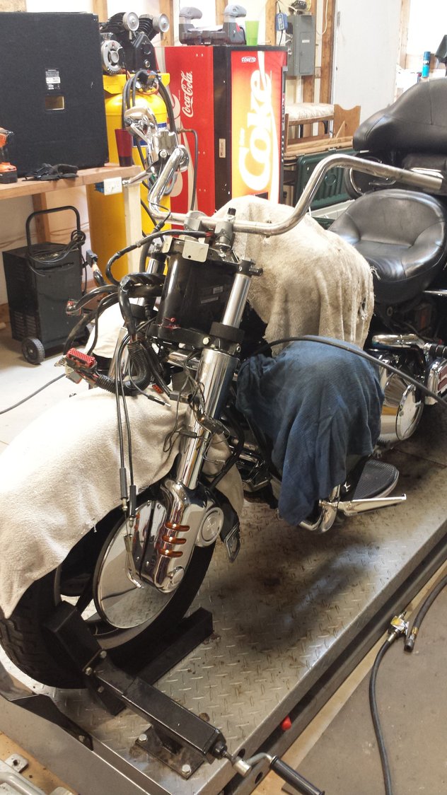

I just took mine apart. Going to repaint the inner fairing. I have plenty of slack on my wires. I believe I can reroute the throttle cables and have plenty of slack. Clutch cable will probably be OK it I run it outside the fairing. If I put it back inside I will probably have to change it. The only thing that looks like it will be tight is the brake line. How are you guys getting slack out of it?
Old Jul 5, 2015 | 12:43 PM
Solex's Avatar
Solex
Joined: Oct 2008
Posts: 214
Likes: 52
From: Central Nc
Oh yea, on the '14 & up the brake line is different and all rubber up the bars, I can see in your pic your steel brake line has no extra, your probably going to have to modify it or buy an extended line.

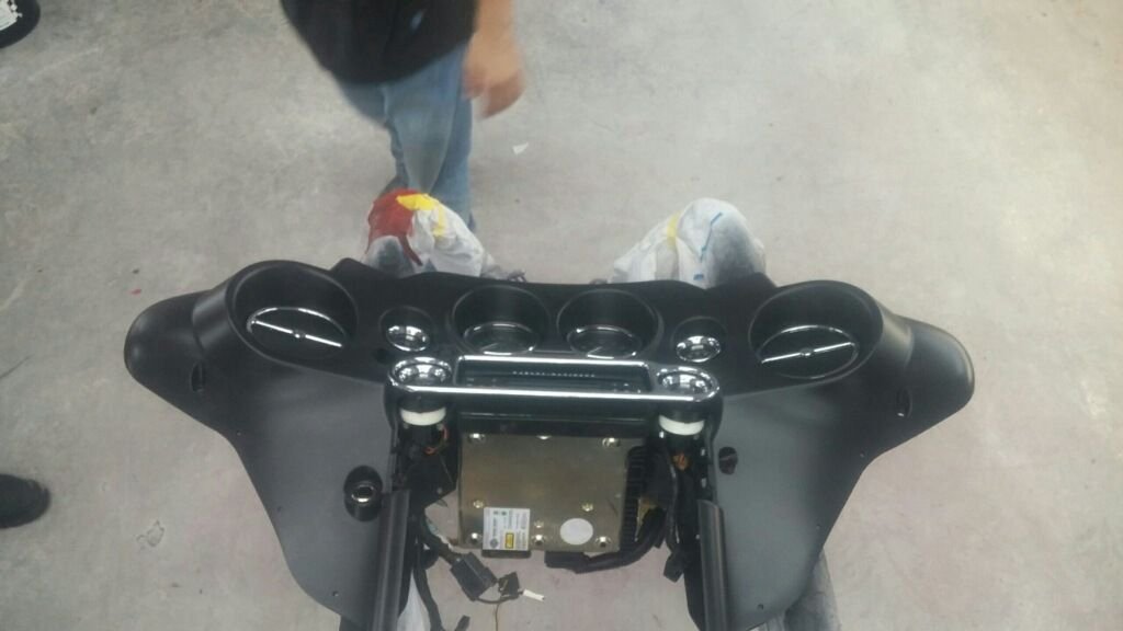

Thanks. I have the bars ordered and a one piece handlebar clamp. I will probably just run the clutch cable outside the fairing. I'm hoping I can make a few careful bends and make the brake line work. I may run the wiring inside the bars if they are long enough. They have alot of slack. One mystery of my bike is now solved. I bought this bike used and ever since I have owned it, if I ride in rain, or wash it, it has always dripped muddy water on front fender. Well, it had the biggest dirtdobber nest in history inside the inner fairing. Problem solved!

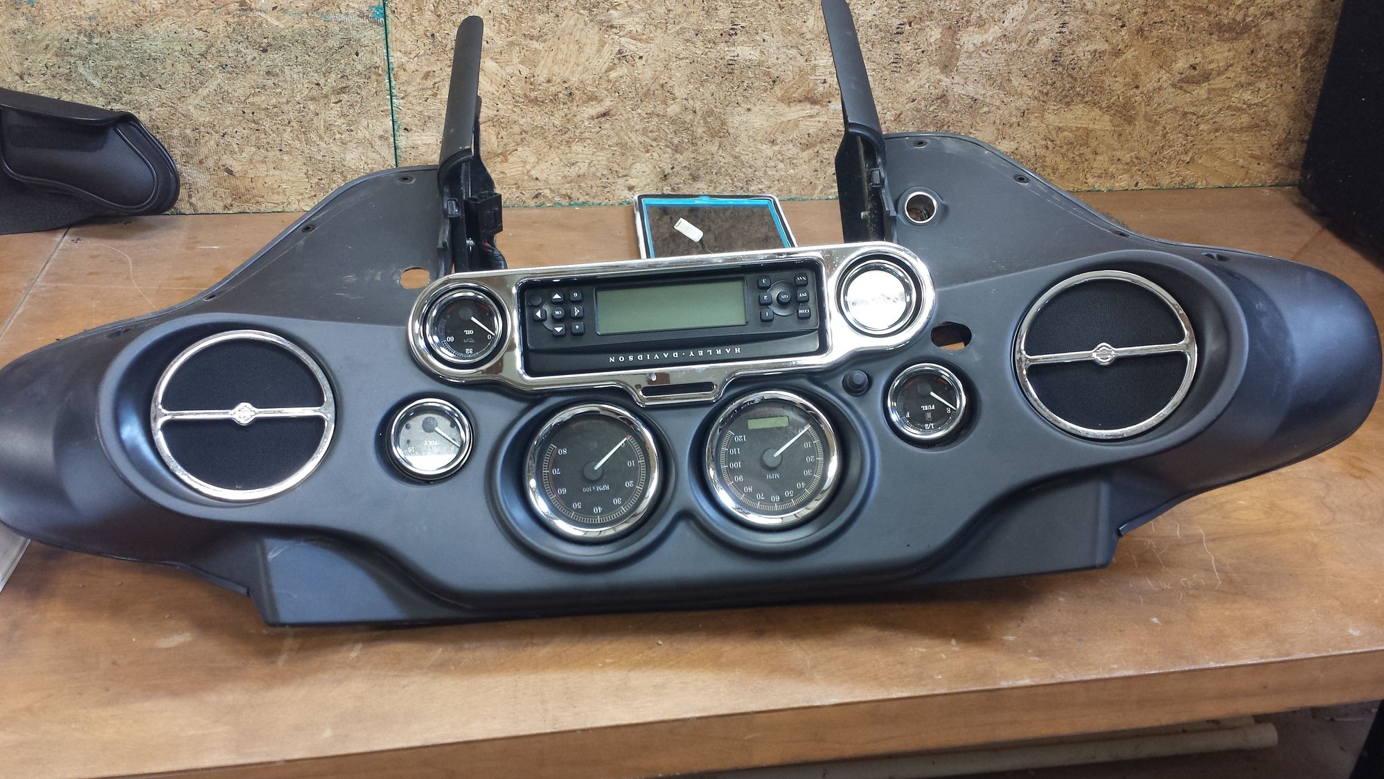

The only reason I'm painting the inner fairing is it is faded on the top edges. I'm just going back with it close to original. One of my Bros is in the paint & body business. He's putting some adhesive activator on it and painting it with some black bumper and trim paint.

Helped a buddy repaint my faded inner faring and lower switch shroud. Turned out great. Bars and clamp should be here by end of week. I will mach fit everything and see if I need to replace clutch cable or brake line at that time.
