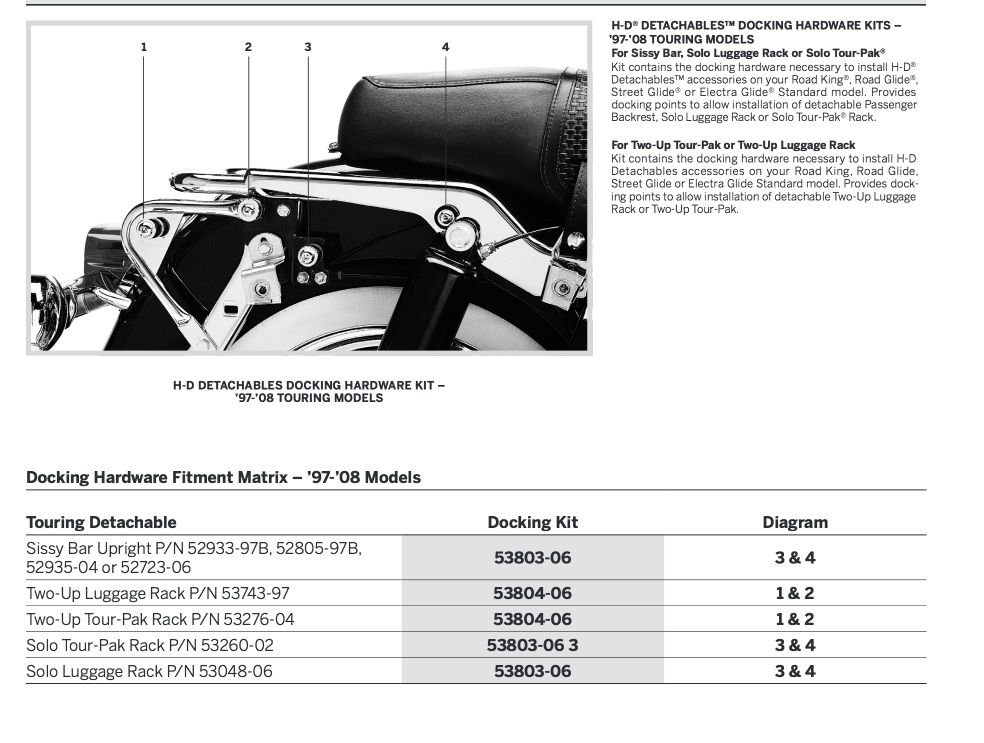

Hey I've got a 2002 Road King Classic with Touring pack. What do I need to fit a sissy bar on there using the existing Touring pack docking hardware??

Same situation here. I think we need another docking point. On the HD website there is a matrix for docking hardware, but it might be easier to ask your dealer. The tour pack rear mounts are used by the sissy bar, but a new set is needed for the front mount.

I have a 2001 RKC. I have 4 docking points. The front 2 are for the passenger backrest, the rear 2 are for a luggage rack.

On my bike, the FRONT mount is actually the one that is used and it's the rear mounts that need docking points added. These added mounts would be mounted just below my air suspension valve stems.

different docking for the two need two more for the sissy bar

Yes, but does anyone know which part it is that allows you to dock with the rear points on the sissy bar? Or does anyone know if there's a sissy bar attachment that uses the 4 point docking system that comes with the Touring Pack??
Maybe this will help?
From HD website:

Part # 53808-06 about $40 1/2 hour to install
have your sissy bar with you at time of install to assure you put the right spacers on (i didnt and I had to fuss with it)

Hey thanks. I actually ordered that part this afternoon. Appreciate the help.

My tour pac uses 1 & 4
