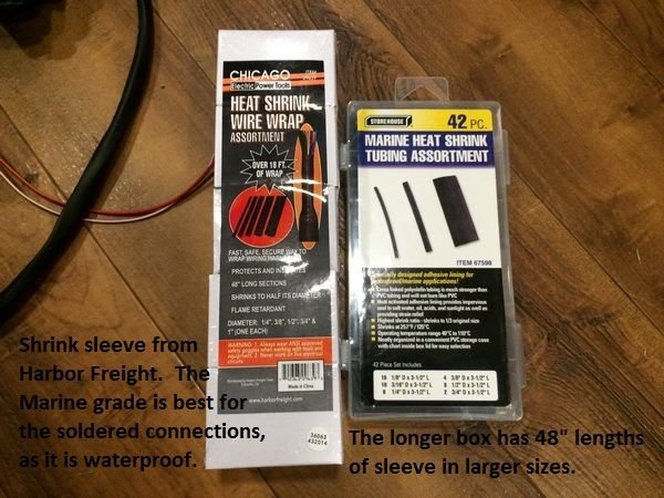

Harbor Freight sells 4' lengths of larger sized shrink sleeve.
