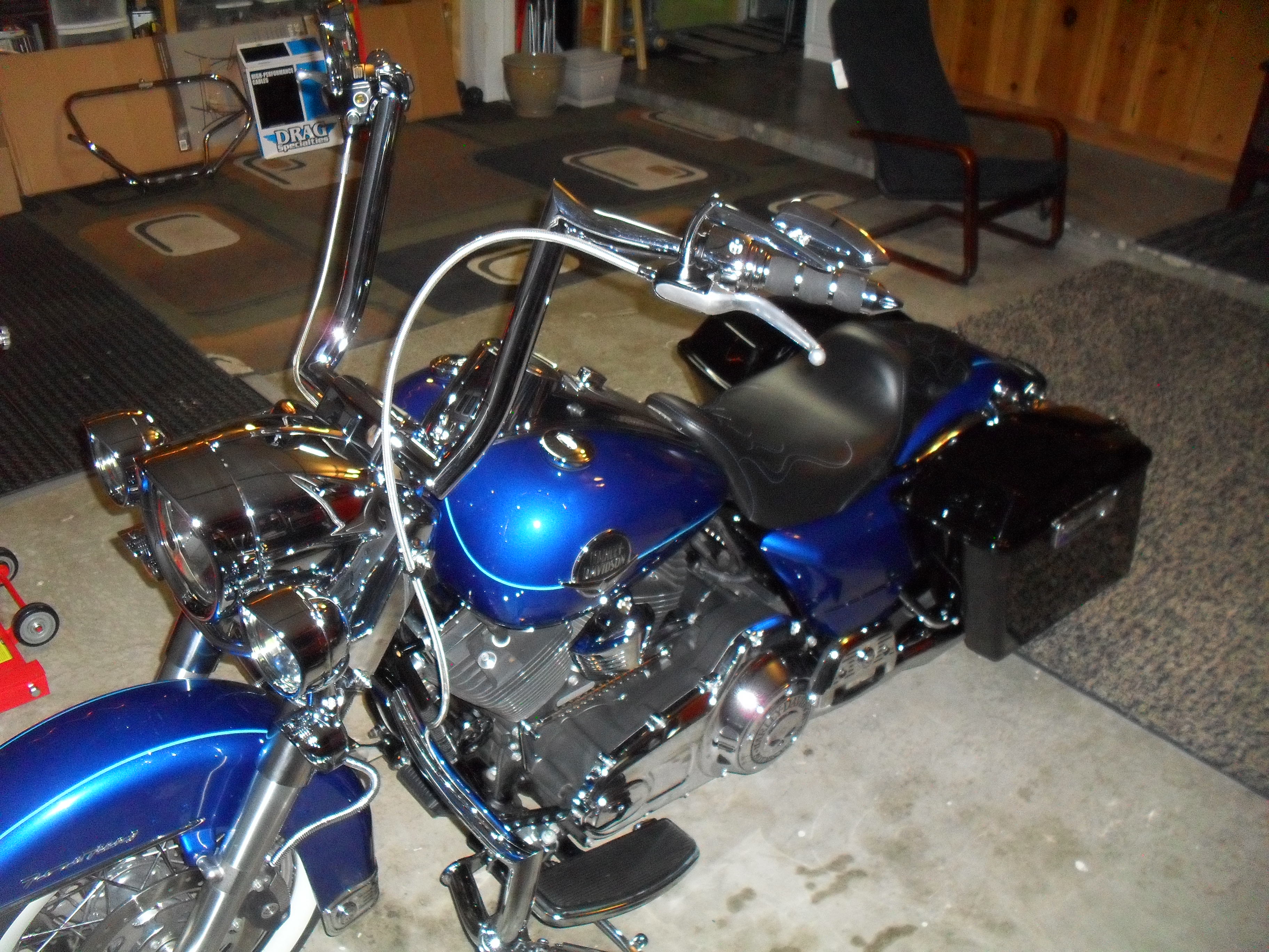

Hey OP...I recently installed 14" apes on my RKC and went with Drag Specialties 74" cable. Seems to be of good quality, so far so good. I do feel I could have went with a shorter cable though but not a big deal...
Not sure why or how you would be able to route it thru the Nacelle though??
It's a thick cable and doesn't have a whole lot of "give" for sharp bends...good luck!
