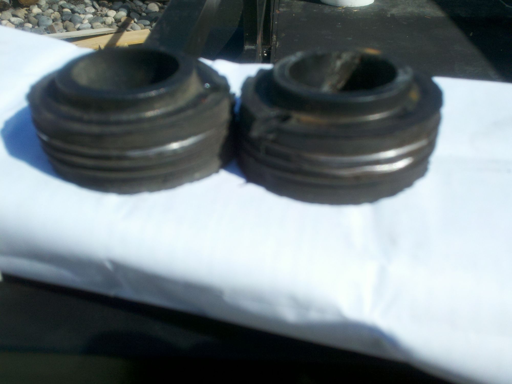

The rubber is from the rear rubber mounts. The stock donuts are junk and don't last very long, at least in the pre '09 models. I know the front mounts changed in '09 along with the frame but the rear set up looks about the same. The picture below is of the stock donuts off my son's '06 RK after just 35,000 miles. The ones off my '08 RK looked about the same when I changed them out. Worn right through to the metal. Tell me that doesn't transfer some motor vibration to the frame. I changed out both of ours as well as a few of my buddies to the Glide Pro set up. His rear bushings and axle have a lot less slop in them then the stock set up This along with his front motor mount really smoothed things out. If yours look anything like these it would do the same for your bike as well.
With respect to the wobble. If your bushings are worn it would create slop in the rear swing arm assembly which would certainly contribute to wobble.

I figgered that slop wouldn't help in the handeling. glide pro set up would cost me over 700 up here in canada so i got a set of stock that will have to do for now. thanks.
It doesn't! Cut one of them in half and show us what you find.
