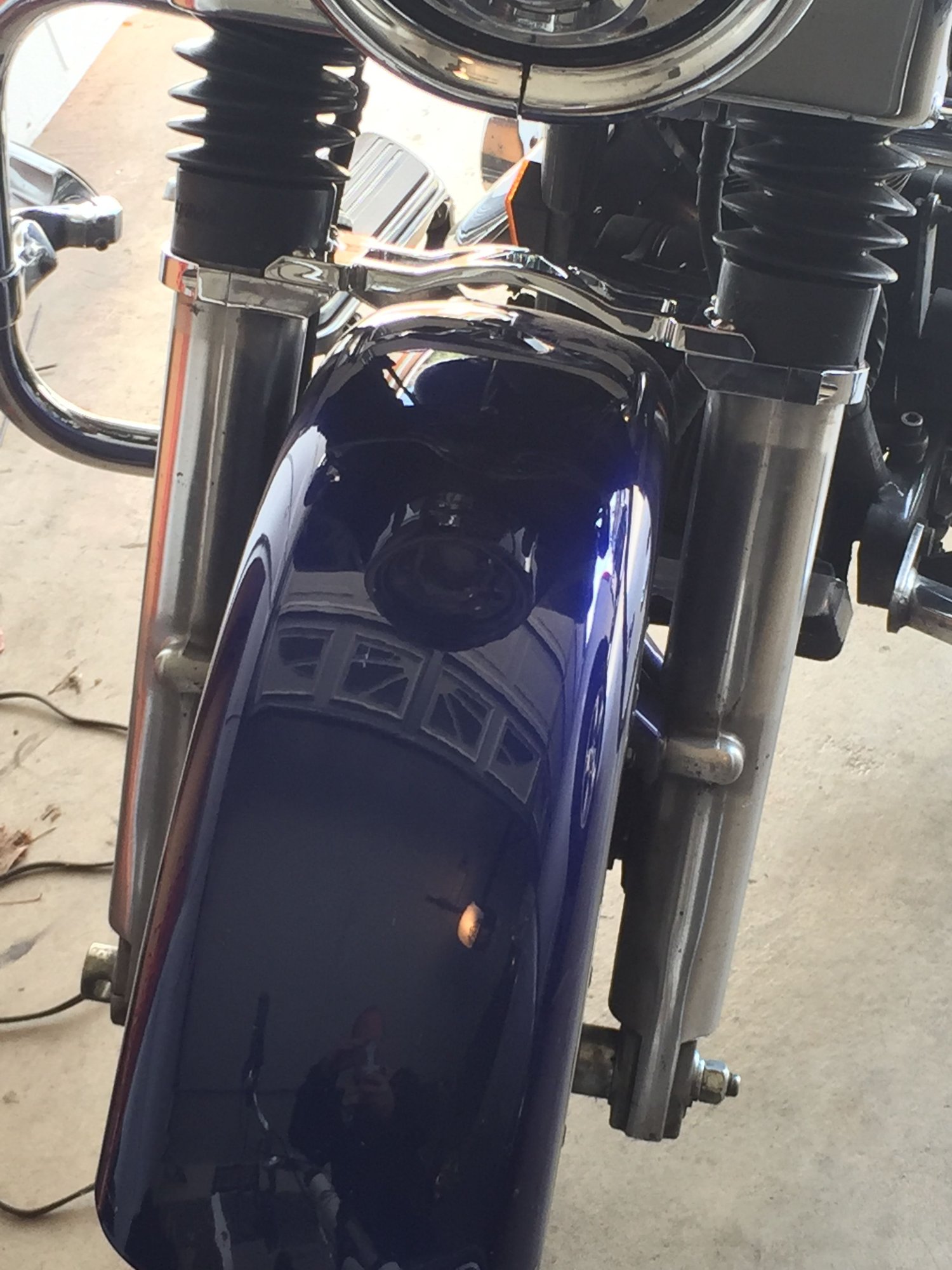

The improvement in ride is worth it even if the rear is all you can afford at the present time. The improvement in stability was surprising. A few years back, I had the front forks redone with progressive springs and Racetech gold emulators, a significant improvement over stock. The front was improved but still flimsy due to the 41 mm forks and bolt through unclamped upper fork triple tree. I just installed a fork brace up front which helped quite a bit. I've got to put a few more miles on it to really check it out. There are NO fork braces available for this bike supplied by anyone. I had to go through a little bit of an ordeal to install this. I had to drop the forks to remove the cow bells and install gator boots. I purchased a fork brace through HD for a 2005 Wide Glide. Bought some take off fork sliders to use as a fitting pattern (since the top of the sliders aren't perfectly round) and take the fork brace fork slider clamps to a local machine shop to mill the clamps to fit.
Nice job!
Great job, I wish Harley made something like this. Brings me back to memories of my '99 Wide Glide, I installed this Fork Brace.
