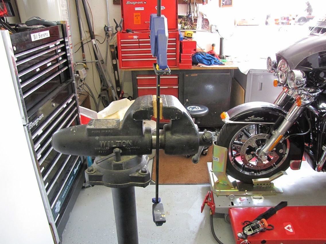

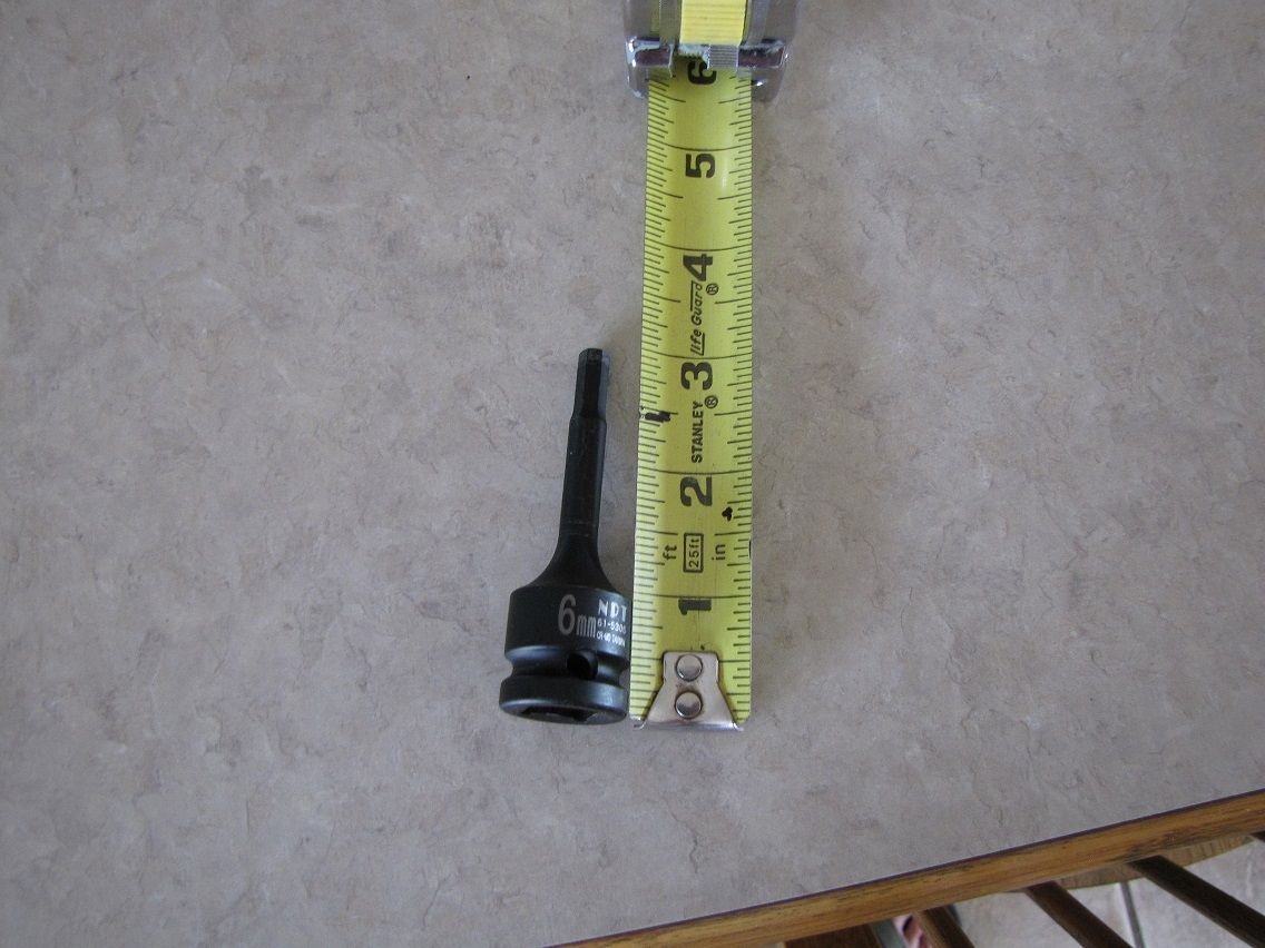

The only special tools I had were the seal installer, socket for allen screw on the bottom of the slider and the one to check oil level .
If your talking about getting the fork tube plug screwed back in to the tube I used a clamp and it made the job very easy.Put the fork cap bolt in the plug then line everything up in the clamp, tighten the clamp until the plug is in the threads of the tube then as you tighten the plug the cap bolt will loosen but keeps everything in place. You can even turn the fork tube to screw into the plug.
