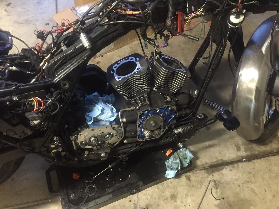

More work has been made. Engine breakdown. Bottom end about to come out.

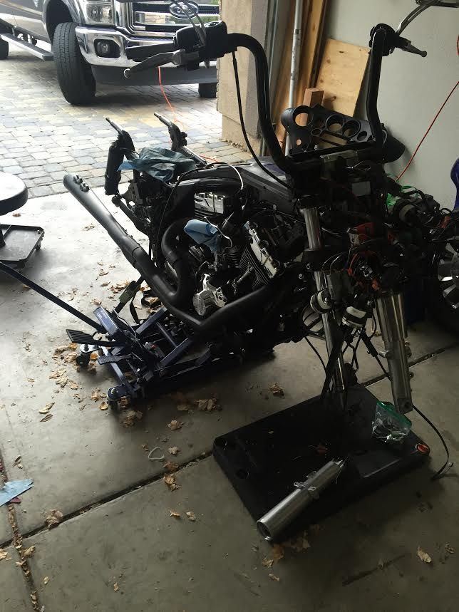

And it begins!
Stripped down and ready to go!
