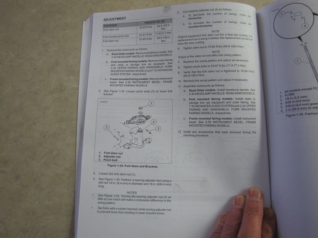

did you loosen the pinch bolts on the lower triple tree?
Old Feb 8, 2016 | 04:55 PM
Vernal's Avatar
Vernal
Joined: Apr 2013
Posts: 7,682
Likes: 8,414
From: Utah
Easy step to miss if you haven't done it or don't have a manual. Me I've done it a few times and still get the manual out to remind myself.

Here's the adjustment tool I made from 1/4" round stock.
Attached Thumbnails Steering Head Bearing Adjustment Tool-image-3766380493.jpg   Steering Head Bearing Adjustment Tool-image-2355022687.jpg

Thanks for all the help and pics. I really appreciate it. I wasn't able to get by the hardware store today but going by in the morning and get the 1/4 stock.

This has served me well.

Picked up the 1/4 stock today, bent and ground it down per the instructions. I was only able to work on it for about 10 minutes till I had to get ready for work. I moved the adjuster about 1/2 inch. The hard part is keeping the tool on the teeth when you hit it. I think i need to grind it down a little more. I'll be able to finish it up tomorrow.
Thanks again for the help.

If I want to tighten the bearing, I come at it from the left side. I use a bungee or something to hold the handle bars all the way to the right. That way I have both hands free and easy access to the star nut and tap it forward. Vise versa for loosening. I also use one of those lights you strap onto your forehead so I can see what I'm doing.
