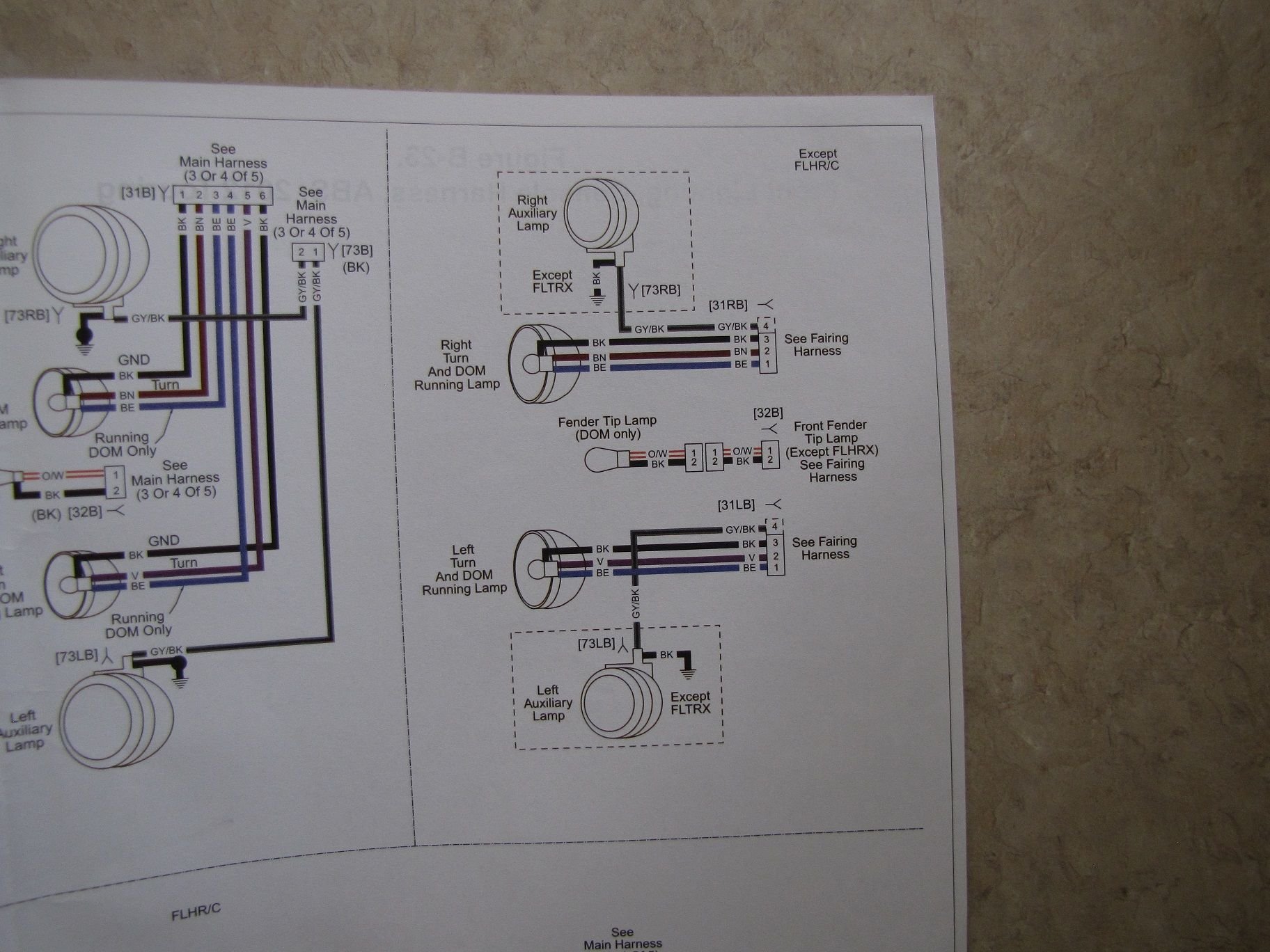

I've been trying to figure out how a bad ground could cause this and I'd appreciate feedback to see if I'm on the right track. Someone posted last week about a similar problem and it didn't make sense then but ....
Looking at the schematics the Right front turn signal bulb is a dual element, BR for turn and Be for running light. If that bulb wasn't making a good ground would the current from the running light go through the turn element, BR wire to the ground with the least resistance which in this case looks to be through the indicator light.

Vernal, thanks for your thoughtful analysis. I think you're headed in the right direction. I've got the service manual, so I'm going to check out the innards. The turn signal is part of the passing light assembly which I installed a couple of years ago. I'll start looking there. I'm a believer in going back to the last thing you did, but two years seems like a long time ago. Still... .
