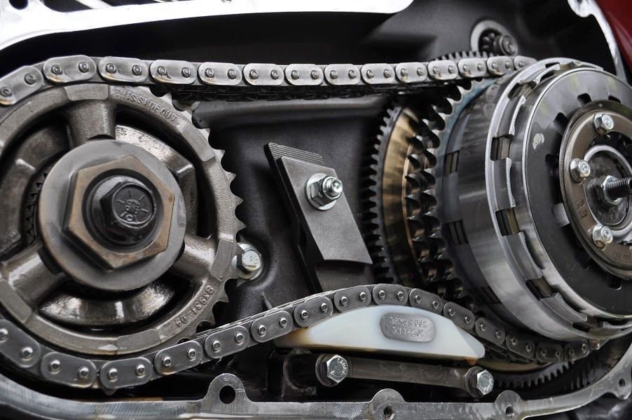

Here's the Baker Attitude Adjuster installed:
