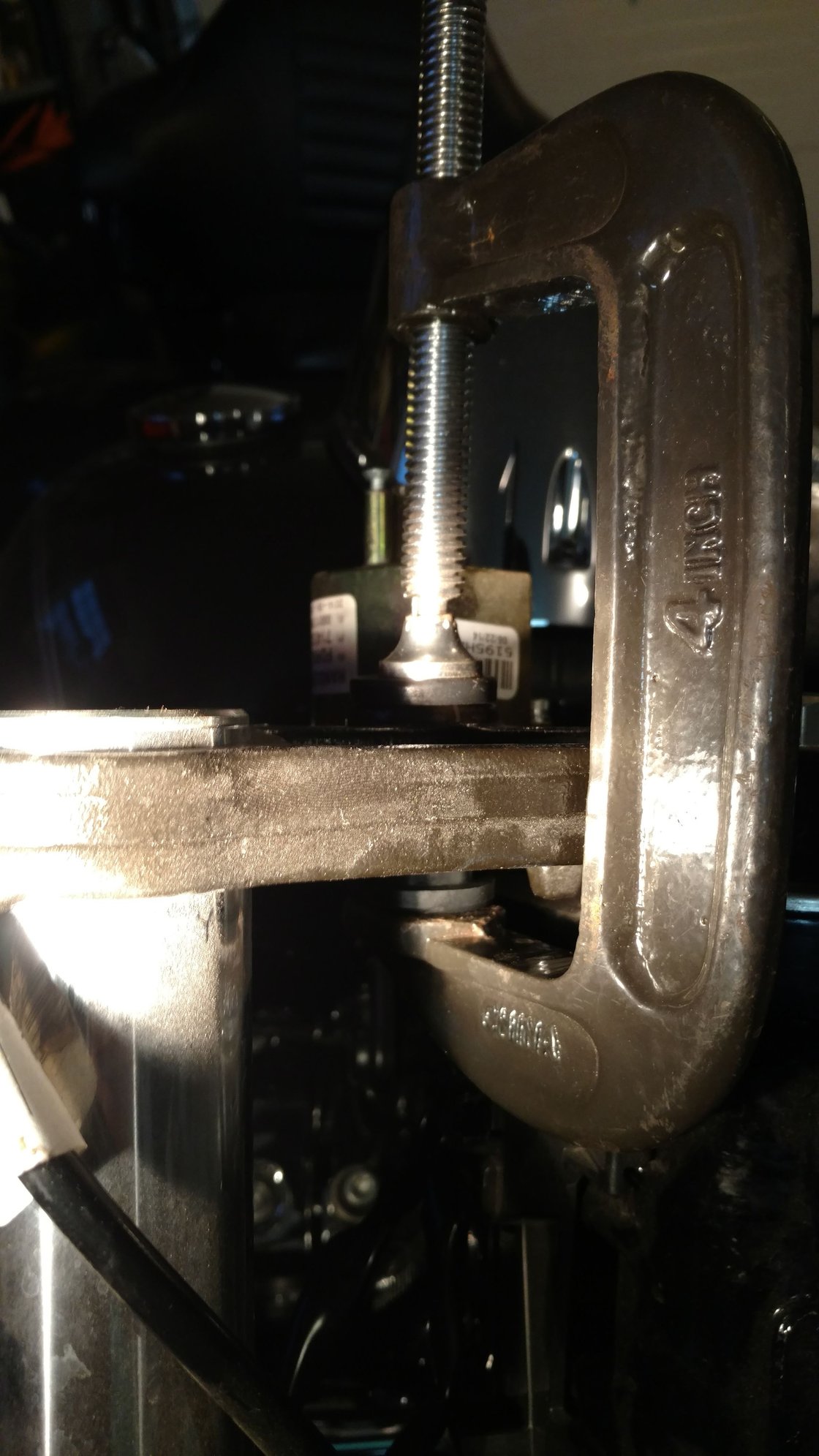

I used a C clamp to seat both bushings at the same time, not sure if the fairing would be in the way, I have RK
Yup you're not going to pull that off with a fairinged bike.
