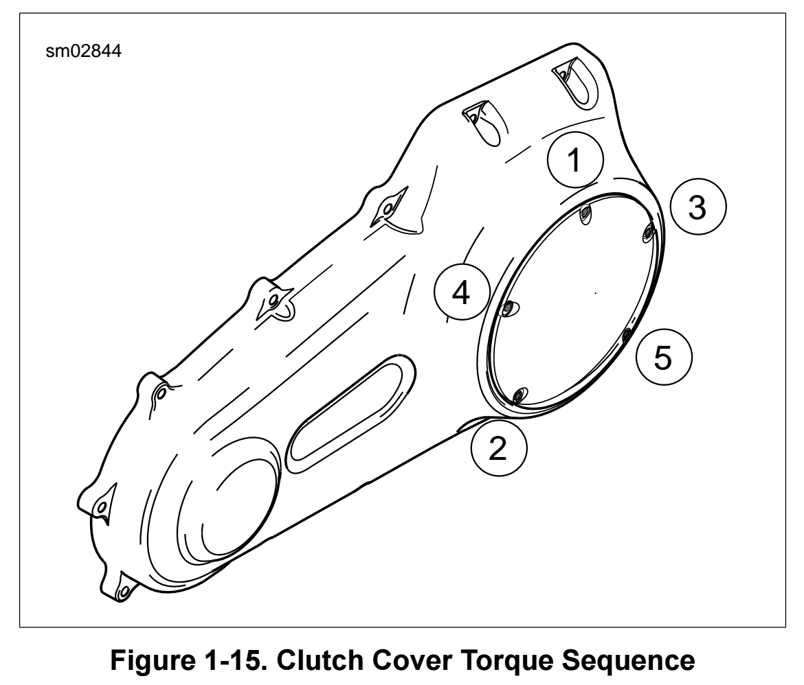

Old Jun 13, 2016 | 07:41 PM
timbo141's Avatar
timbo141
Posts: 1,421
Likes: 277
Originally Posted by dandrumheller
Thanks for the tip. Now I have a good excuse to get an impact driver.
Yep, saw lots of 'Don't use T-25 bits on those' threads. Have a T-27 and a torque wrench.
Can anyone confirm 84-108 in/lbs for 2011? I Guess 90 would meet both specs I've now seen posted...
T-27 and torque wrench is recommended and follow this torque sequence:.

I believe that, in the case of the derby cover, the actual torque numbers are less important than that they are evenly tightened in a criss cross patern.
I've also had mine off half a dozen times and never replaced the gasket with no leaks or other issues. In fact, my FSM clearly states that cleaning and reinstalling it is perfectly acceptable as long as the gasket is not damaged in some way. Clean the gasket and the groove it rides in and install the cover.
