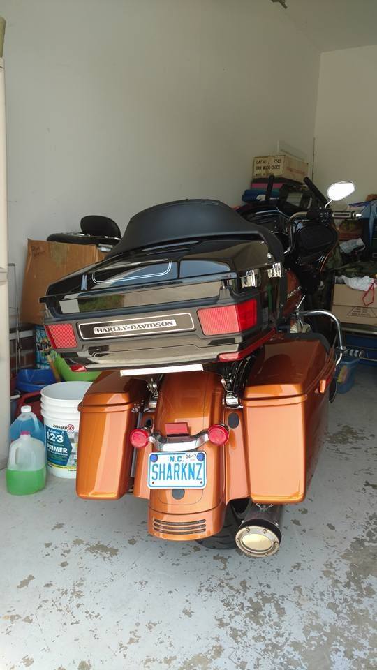

I just bought this tour pack off of 2010 Ultra I believe. It has lights on rear and the lights on bottom edges. I need to know about wiring, suggestions on plugs for QD etc... Are the lights on the back for Run / Brake and Turn? I presume the Led bars on sides are just running lights?

It's been a while for me because I have the conversion kit on mine but I believe the big corner lights are just brake and running lights from the factory. I have the harness that converts them into run/brake/signal lights and really like that idea of extra visibility to the rear. The side lights are just running lights but I think someone makes a conversion for that too to turn them into signal lights. Maybe someone else will speak up now that I've broken the ice!

I put a tour pak on my 13 streetglide .the lights on side are running lights,the lights on rear are run and stop.anot her module/harness is needed for turn signal.
