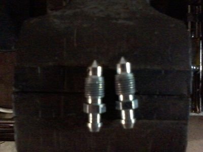

got some Speed Bleeders. did come with thread lock. will let you now how things go.

well, air seems not to be the problem. put new bleeders in, new bleeders did stop the massive air flow. harbor freight ***** pump kinda does suck, pump **** tends to *** out if squeezed in to much. was able to put rod back in to pump. got what i paid for!
front breaks do work, they have to be pulled in to just about all the way for them work good. if i pump up the front breaks, they will work better. once i let go, break lever goes back to being limp, has to be pumped back up. thought this was air, seems i am wrong.
