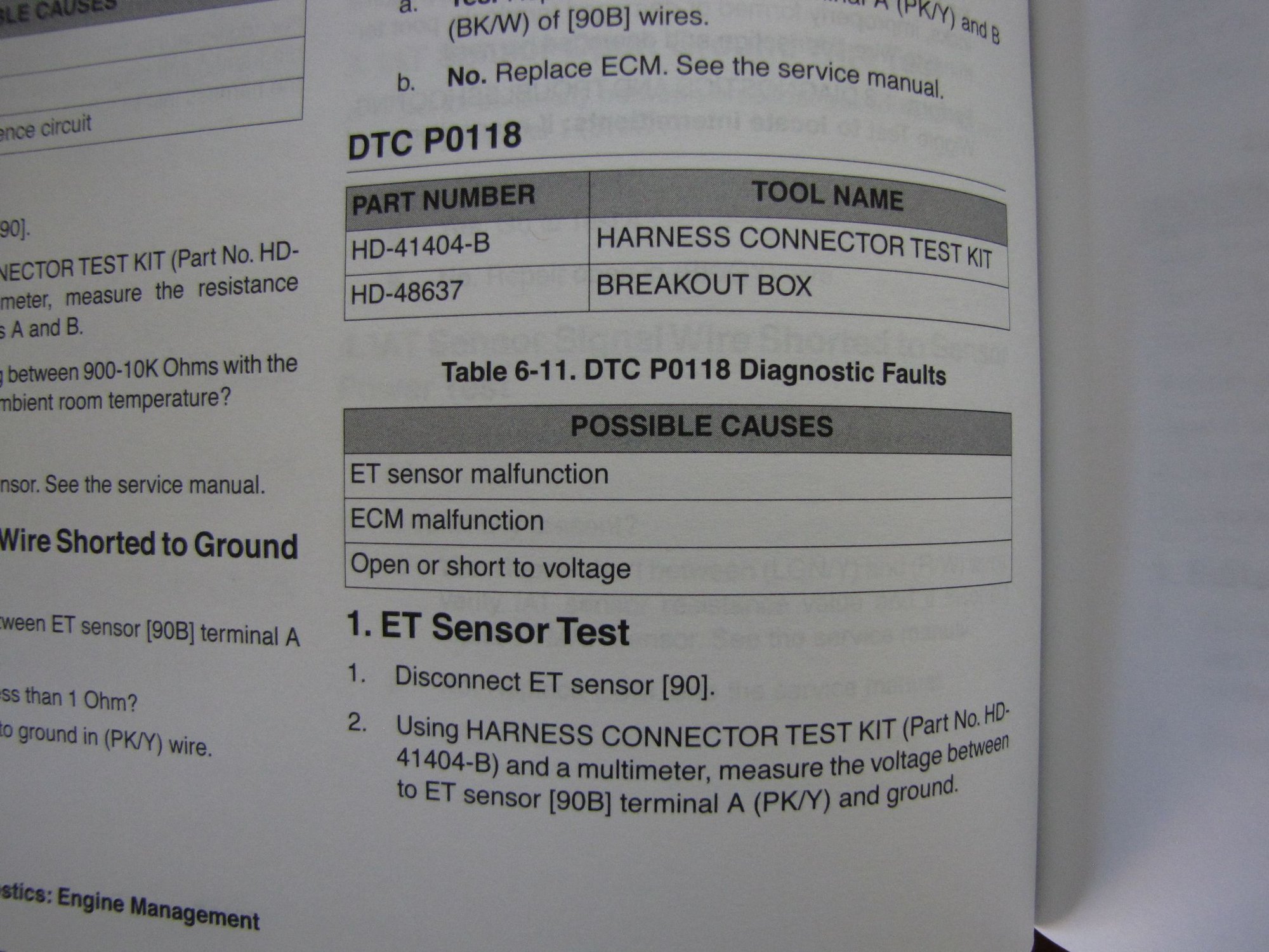

New to the forum and need some help. I have a 2011 Street Glide bone stock on the motor side with the exception of Reinhardt slip mufflers with a little over 60,00 miles. I left for work yesterday morning, about 4 miles out the engine light came on and the engine went to about 3000 rpms and stayed there. I checked the codes and got P0118, Pn 32836-09A and Pn 32933-11. Any help would be appreciated.

From the 2010 manual
