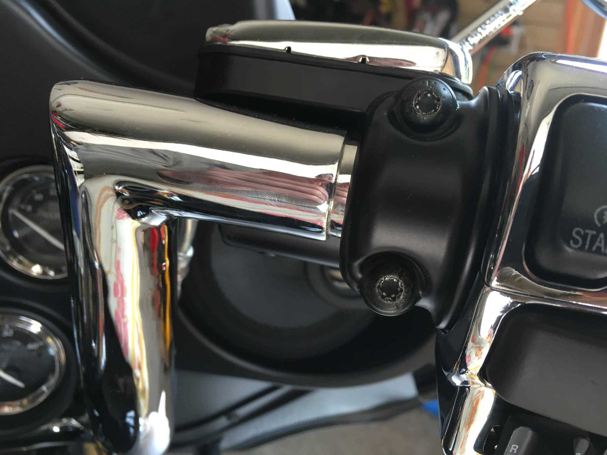

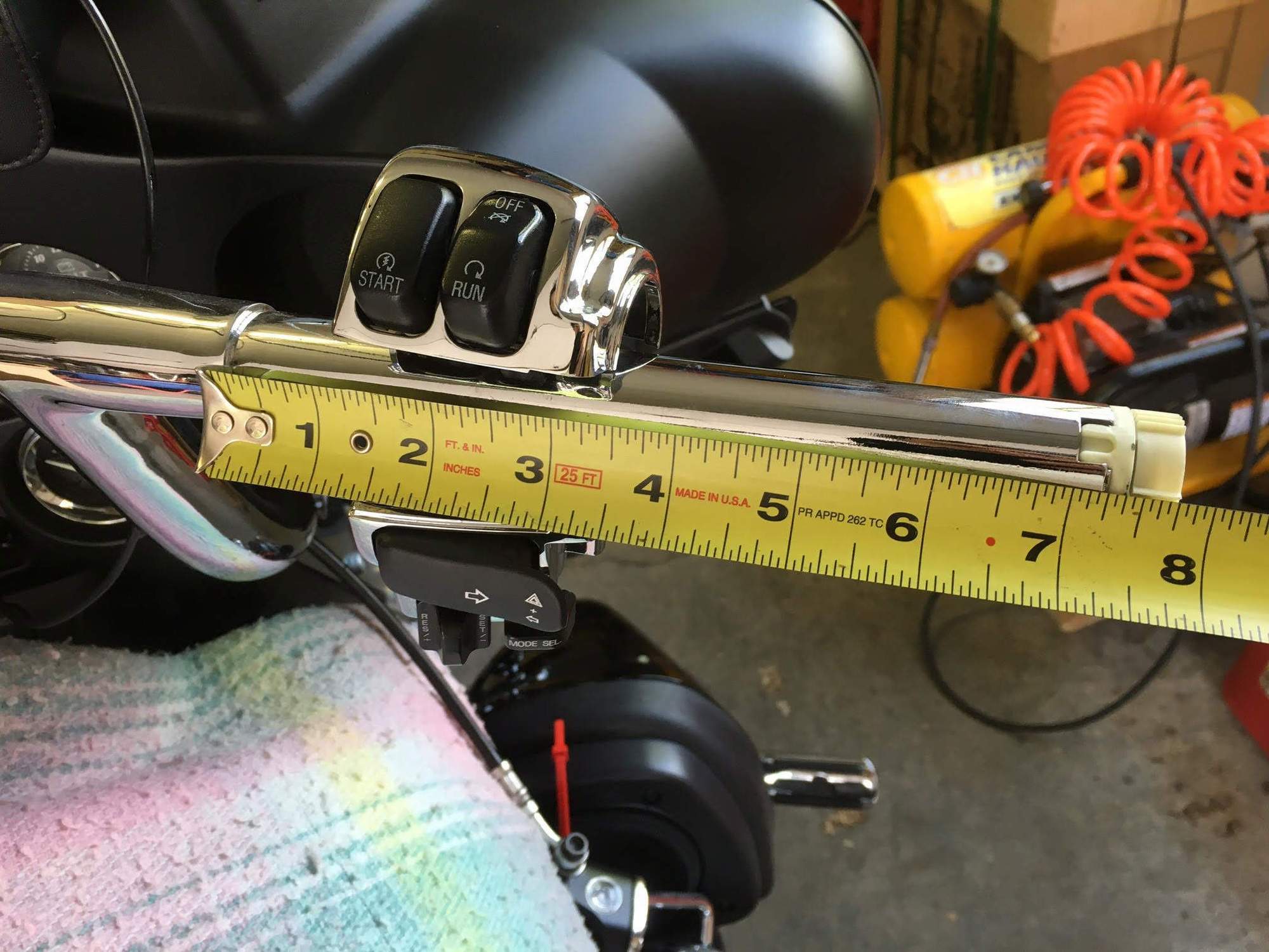

On a related issue.... check out the gap between the controls and where the bar steps up. I've switched to a HD Airflow TBW non-headed grip #56100108.
FYI - I'm been in touch with LA Choppers and they've been great. After exchanging numerous photos and measurements. It looks like the issue may be a variation in the size /width or depth of different HD OEM Grips. Obviously not an issue with thinner bars... but I may investigate aftermarket grips that might be longer.
Has anybody else had a similar issue? Just something to be aware of...

I'm using the Kuryakyn ISO grips and didn't have any issues like yours FLHBK. Everything fit together perfect on mine.

Originally Posted by FLHBK
No problem as well... however all things being equal if money wasn't an issue... I probably would have gotten a longer clutch cable but it's not "necessary". The brake is fine.
I have the same problem you do. I have PM grips.

Originally Posted by nickrat
I put the 10" LA Choppers Twin Peaks on my 2013 EGC without changing the brake line or clutch cable. I did reroute the clutch cable to come up between the radio support and the inner fairing and I also got the SE tbw to get rid of the green connector.
Ditto. I too did the same thing with my clutch cable and didn't have any issues when I installed my LA Choppers 10" Twin Peaks.
I didn't have any fitment issues with my HD grips and controls not mating up to where the bars went up to 1-1/4" diameter.
