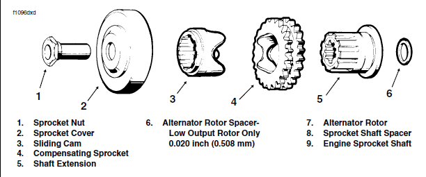

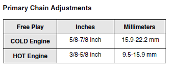

Default if you are sure the noise is coming from the primary
could be wrong but, sound like your chain is loose. sure you know how to do this but, i am bored.
this is how i do a 05 road king primary check up?
first i find the inspection covers:
inside i will see:
then i make sure chain is adjusted to:
also check to see if the Compensating Sprocket Nut and the mainshaft Nut are tight.
well that was fun. hope this helps

I'm having a unusual sound down there also. Went for a short ride yesterday and started to hear a rattling/clanking sound that I've never head before. It progressively got worse. Got home and put it up on the lift and sounds like it's in the primary. Did some research and read where it's common for the compensator nut to loosen. Does this sound familiar? Hope it's as simple as taking the primary cover off and tighten back up.

2014 has an auto tensioner. The compensator nut is exposed with the outer primary removed.

You will need to clean the thread and re apply loc-tite. I do not want to turn this into an oil thread, are you running formula plus in the primary? I had a similar noise , checked the bolt and the tensioner found no issue with neither changed fluid from syn 3 to formula plus no issues since.

I have a 2012, I'm sure HD didn't figure out they needed an auto tensioner until after that. But anyway, am I just removing the primary cover and tightening the nut. The graphic above showing the bolt sequence is interesting. I will follow it if it's crucial how the bolts are removed and installed

The bike needs to be on a center stand. Drain the primary . To remove the outer primary use an impact screwdriver and the proper bit. The screws are different lengths. Replace the screws in the same holes. replace the gasket(s). IF u remove the comp bolt, replace it. use a torque wrench. you will need something to jam the primary chain while tightening the bolt (160ft-lbs). if you're tempted to check the clutch hub mainshaft nut, be advised it's is CCW to tighten and torqued to 80ft lbs. be careful tightening the primary drain plug - it strips very easily.
