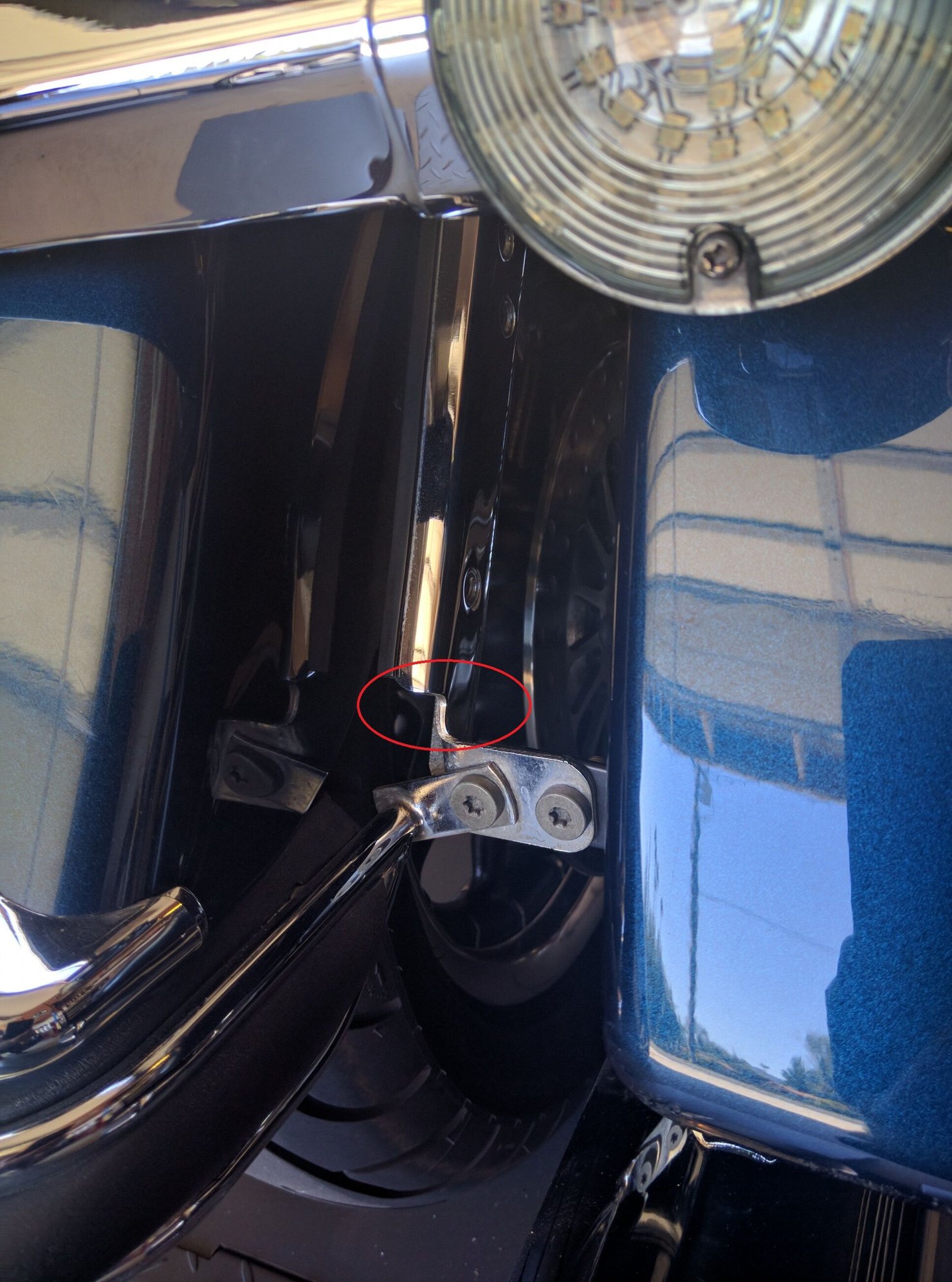

All, yesterday I notice my left side exhaust and left side saddle bag shake really bad at idle whereas the right side is rock solid. I cannot shake the left w/ my hands, but when the bike is idling it is obvious that one side is moving and the other is not. I plan on taking an indepth look when I get home from work, but what should I be on the lookout for? Any specific hangers or bolts that would cause this?
Also my tri-bar fender tip light buzzes at idle because of the shaking. Has anyone ever found a reliable way to make it stay tight? Thanks!

Pull off your saddlebag on that side and look where the bracket comes down to connect to the saddlebag rail. It's probably broken.

I had the right side break near the bottom, just above where the saddlebag rail attaches.

As well when you get home put the bike on the stand, let it idle, and look closely at things. Like the above spot mentioned. If it's not there, you'll likely find somewhere else where dramatic motion is happening, right next to something that is not moving, but should be joined.
