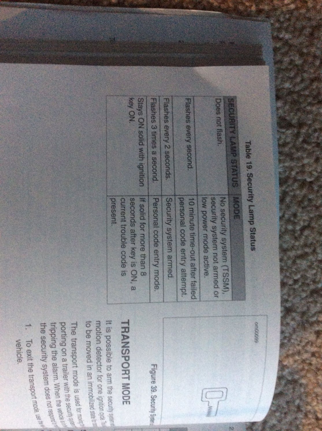

Has a code been entered previously? Do you have your owners manual?
Here a pic from my '06 Softail owners manual. This should tell whether a code has been previously entered.
If you want, PM me with your email and I'll photo the other parts of the manual on security.

Not sure if it has a code set or not. I assumed that when using the procedure I was following above it would display the code if it were set.
Old Dec 25, 2016 | 02:11 PM
SiggerTX's Avatar
SiggerTX
Joined: Apr 2015
Posts: 603
Likes: 14
From: So Texas
Made some progress on this. As I figured the odometer not displaying digits meant that there was no code set. The trick to getting thru each digit is to double tap the fob button after entering the digit. I have confirmed that my new code is stored.
Now when I went back to test the disarm I fumbled again. Armed system via fob. Ignition switch to accessory, hold both signals correct? All that does for me is make the security light flash rapidly...

"Now when I went back to test the disarm I fumbled again. Armed system via fob. Ignition switch to accessory, hold both signals correct? All that does for me is make the security light flash rapidly..."
Once the security light starts flashing rapidly. that is the indication that you have to enter your code using the turn signal buttons.
Press the left button the correct amount of times to enter the first digit of your code and then press the right to confirm that digit as being entered and it will move you on to the next digit of the code. Once you've entered all 5 digits correctly, switch the ignition switch across from accessory to ignition and you should be good to go.
