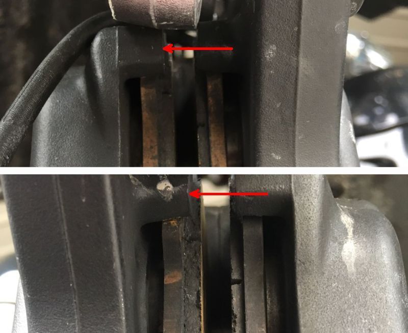

Is this normal for an Ultra?
Dealer says this is okay but to me it seems like excessive drag. I removed calipers, cleaned and pushed piston in a little by hand and the front wheel spun freely for 5 or 6 revolutions. It was noticeably easier to walk the bike around he garage. Couple pulls on the lever and it's back to this. I don't think the pads are returning enough.

Carl, does it look like something has been rubbing (like the rotor) on these two surfaces?
I originally misunderstood your question. You are asking if the caliper body is rubbing the rotor and it is not. No abrasion at all on those surfaces.

Cleaning up the caliper is something I tried back in fall of 2015. It seemed to help at first but reverted back. There is something odd about the left side of each caliper showing more wear than the right. That suggests to me that one or both left side pistons are more resistant to release than the right. The only logical explanation I could come up with is that the seals on the left were damaged during years of sitting on a side stand.
