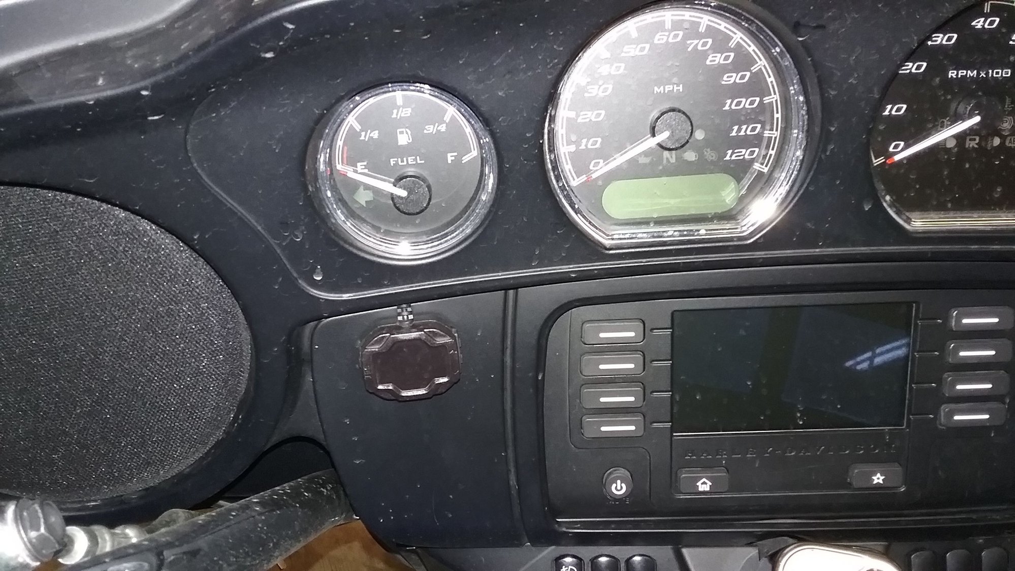

According to my research, virtually all of the wireless sensors go to sleep until the tire moves. The only other option would be to have it transmit all the time, which would kill the battery.
As for the original post, I like the display of that one, but that would require mounting a lighter socket and seems like it would be prone to falling out or being stolen.
I went with the steelmate and here is a photo of it mounted. As others have said, get steel valve stems. I had my wheels balanced with the sensors installed.
