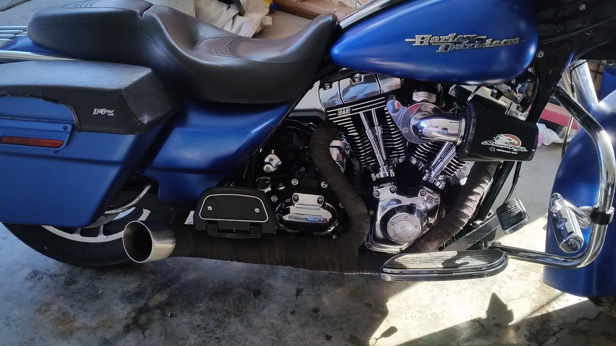

Exhust is done looks great and sounds nice will post a link to my youtube on how it sounds later..

I like the wrapped look of your exhaust, who makes the pipe? ?

I made the pipe my self ...2014 street glide down pipe, cut at the cat gutted, then got a oval to 3 inch round off of amazon. Then stopped by a friend of mine that owns a mug shop he cut me a 3 inch 45* and ordered me a 3 inch to 4 inch weld on car tip. Tig welded it all to gather did some grinding then installed the heat tape.

Looks good man. What kind of collector did you use?

the header wrap looks good
