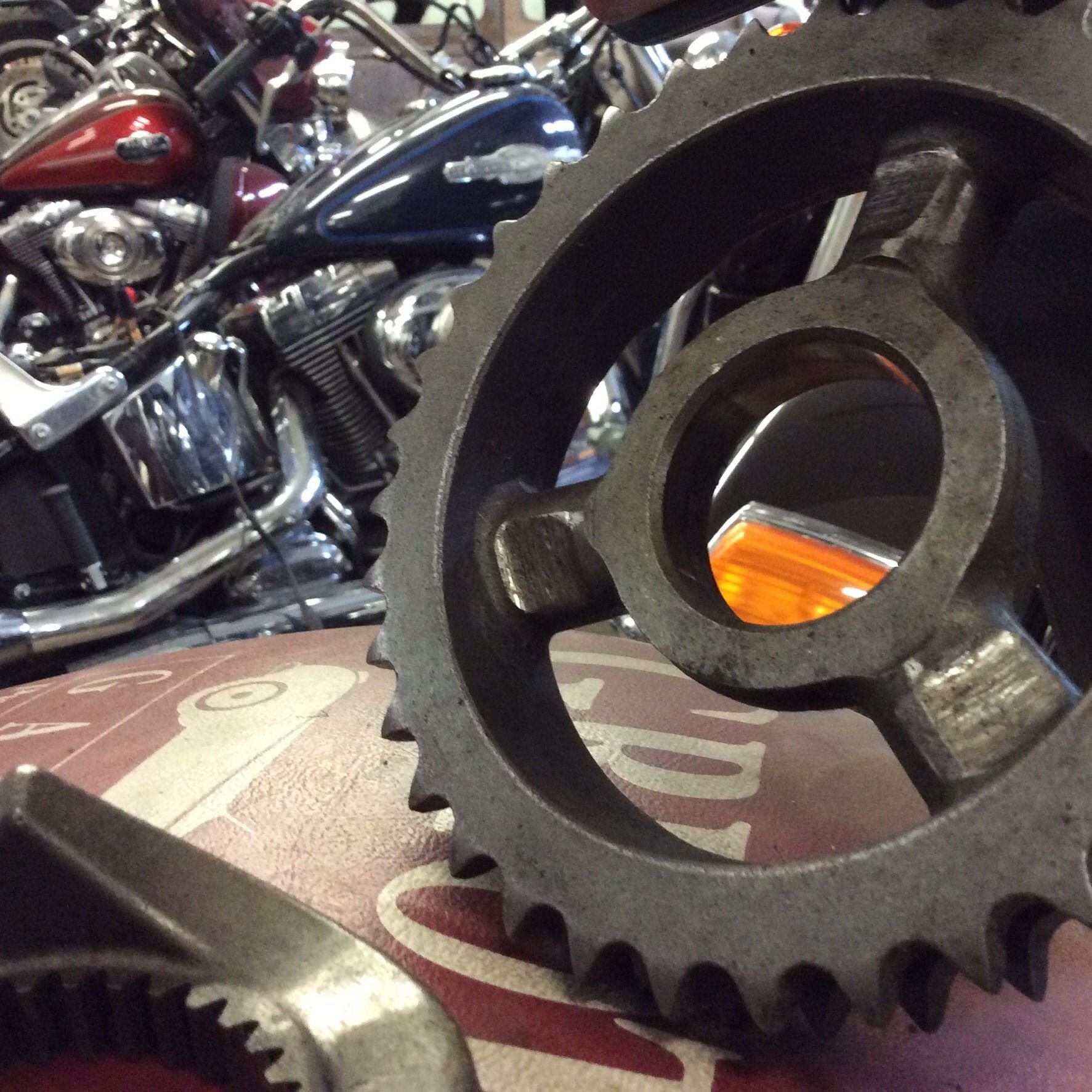

Now here is a fun example of " I have no problems with my compensator" This is out of a friends 2011 ultra. Pulled it a part to just for a check up before a long trip as Harley had done all the service from new . Had 13k on it and out of warranty. He was pretty surprised to see this one. I don't get why maybe the ramps didn't wear a bit more before the sprocket spokes. Notice teeth are perfect and it had plenty of that super spiecial HD oil
No blue ing either. Going to coat one or two of these for this years riding.

In what condition are the springs, especially the small one? Did you experiment to see how much torque was required to shift the crank shaft to near the limit of the end of the wear marks on the cam? Was there any fretting in the hub, the light wasn't too good to see that in the pics. I am still wondering about eliminating the smallest spring with a shim so the intermediate springs take most of the load.
