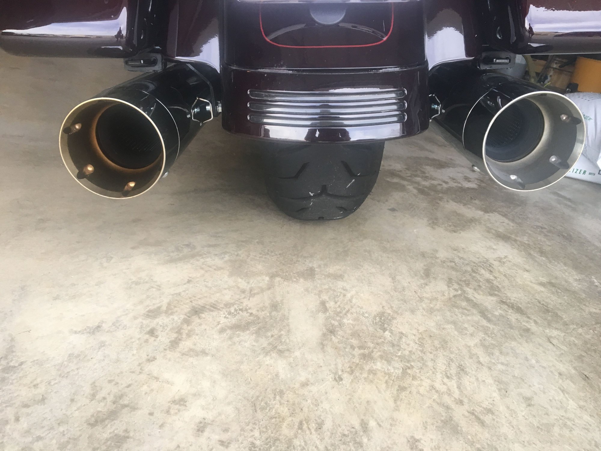

just put VH 450s on and after a day of riding I have one that is clearly running hotter or something.
Loking for input-
Thanks-

Are you running a Power-Dual headpipe? If you are, they all do that. The exhaust gases are just taking the path of least resistance to expulsion. Mine do that and all my buddies that have the Power Dual headpipe do it as well.

No- just stock everywhere except the slipons.

Might still be a valid answer. The crossover pipe comes off at about an 85 deg. angle so the hot gasses are still tending to go to the right pipe.
