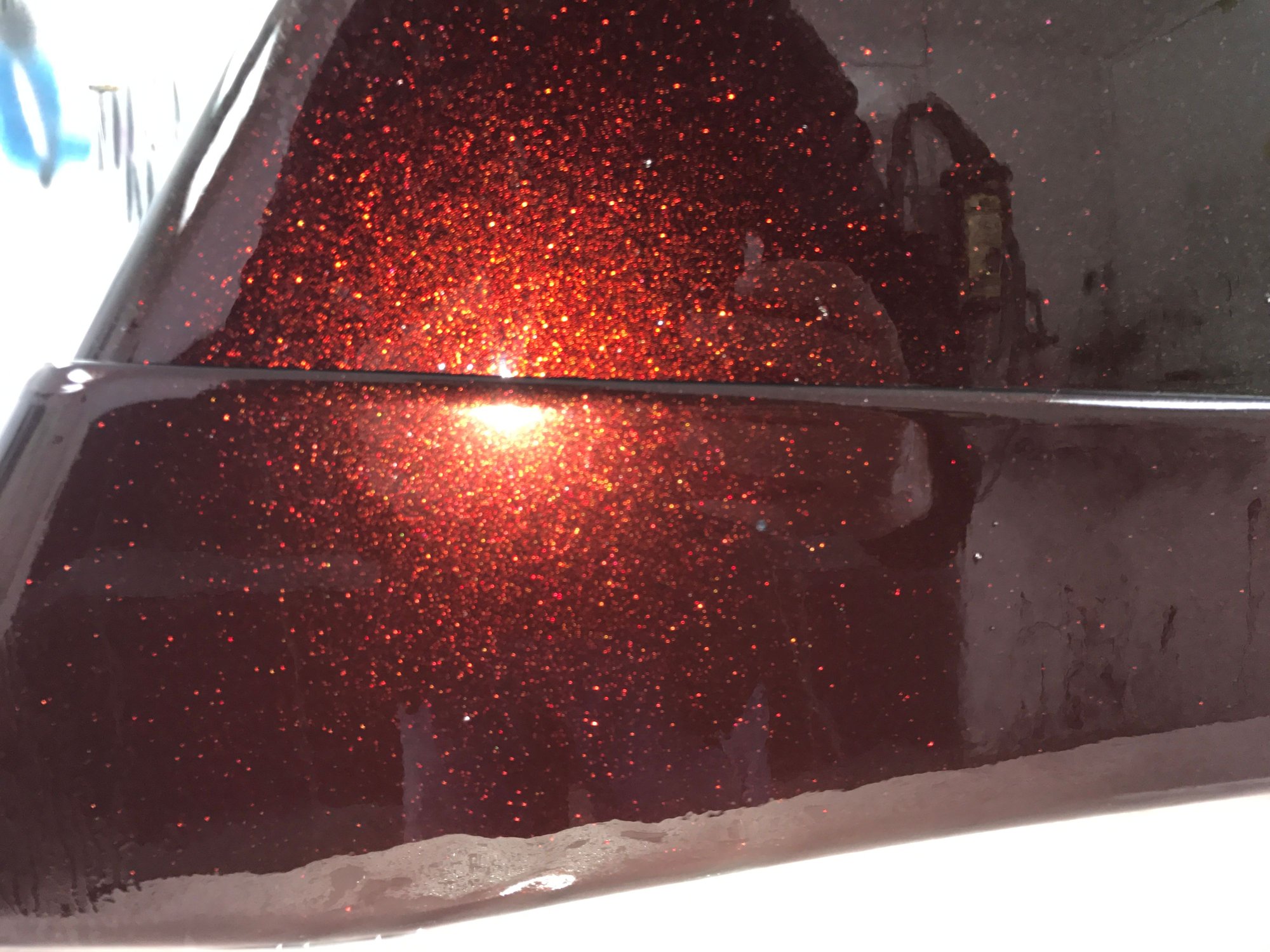

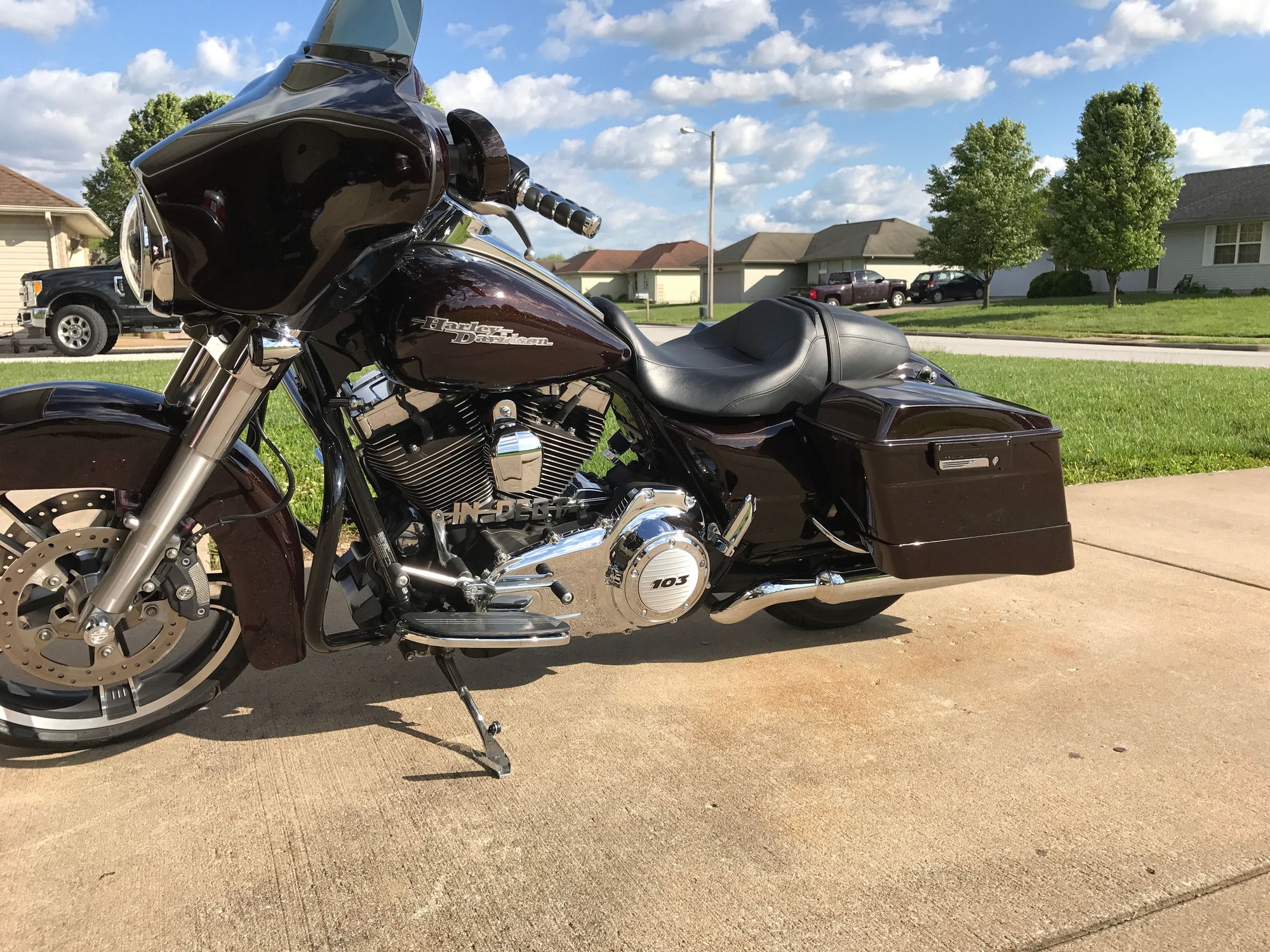

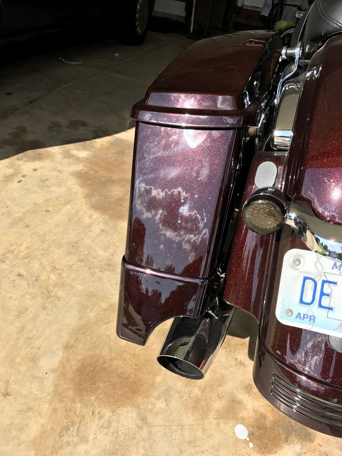

After a few more samples sprayed, we figured out the issue. Was spraying like it was a normal color (light coats). Sprayed it heavy like you do with clear. 2-3 coats is damn near spot on. Will get pics of the bag extensions soon.

For me, it took 2 good coats of the base black and 3 coats of the merlot. If I didn't get the base dark enough, the color was too burgundy.

i did 2 coats base. No matter what I did the ppg came out to brown. Got some from matrix and it was to red. 2 coats of ppg, 2 coats of matrix, three coats of clear and it came out close to perfect.

great looking bike mate.

get the vivid black i ordered my merlot sunglo from color rite did my spray out and 1 coat of mid coat looked good to me ,do some spray outs and check it with side covers in the sun
